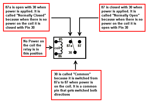

Don't i need to use pin 30 for the device as thats the comon pin,i see (12v) and Neg output and ground
Or do i use 87a for to activate the trunk wire

Do i use pin 87a to activate the trunk pop wire then
because i see 12+, neg out and ground
also isit pin 30 the common pin,woulded that go to the trunk wire

Your trying use something that has a (+) output to pop your trunk which is (-), if that is correct you can wire up a relay like shown above.I normally would tell you to have the (+)trigger input to 85, and have both 87, and 86 to ground...that would give you a (-) output from 30. either way is the same effect, just the12volt.com's pic was easier to use than making one of my own.hopefully that helps ya out.

So that you understand what pin does what. Here is an internal diagram.

Alright i was just going over all my wireing info and yes the factory trunk wire is (+) and the output from the RS is a (-).
So that diagram posted above will work just fine
