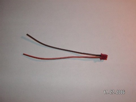

Other thing, the installer never gave me anything back like installguide, toggle switch, hood pinswitch e.o. What they gave me back is the user manual, which doesn't show you almost anything, and a little red harness with brown and ORANGE / balck wires. I'm wondering what this 2 wire harness is for. Is it for the toggle siwtch to disable the system temporary or is it for something else? See the pic below.

Harness H4
H4/1 - ORANGE / Black - Channel 6 Output - Provides (-)200mA output whenever the transmitter button(s) controlling Channel 6 is pressed. (connect to a relay only)
H4/2 - Brown - (-) 200mA Horn - provides (-) 200mA output to the horn when programmed (connect to a relay)
