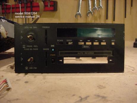

Hello. This is my first post here(second now). I've been all over the internet and joined at least half a dozen groups and cannot find out an answer to this. I have a Delco am/fm cassette from a 1988 Chevrolet Celebrity Eurosport VR. The model number is 16041264. Servivice Manual 2H. Its a regular ol' factory stereo from any number of late 80's GM cars. I want to put an AUX 1/8(3.5mm) stereo plug in it to play my iPod through. I have 2 of these stereos torn apart on my workbench right now that I've been tinkering with for quite a long time.

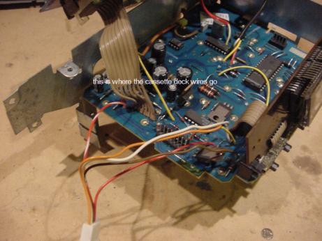

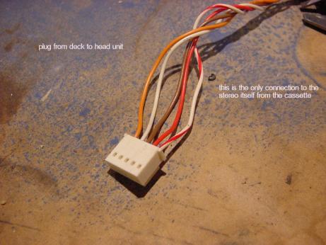

I'm assuming he's cutting the feed from the radio and replacing it with the feed from the 3.5mm plug at the cassette deck. Thereby fooling the amp into thinking its being fed by the cassette signal. I figured out how to cut the radio signal, but can't get a signal from the mp3 player. There are 5 wires connecting the tape deck to the rest of the stereo RD, R/W,BRN,OR,and W. I put a switch in the red wire. That cuts the radio signal going back to the amp in the RED / white wire. I spliced into the other 3 wires with a 3.5 stereo receptecle. When the switch is thrown, it cuts the radio signal, and should allow the mp3 signal to pass to the amp. Should being the key word.  So I put the switch in the R/W wire. Now I get a signal, but its overpowering the amp. The speakers only "thump" the bass line of a song.  So I then put some 100uF caps on what I think are the 2 channels from the iPod that I spliced into. The music is now there, but is weak, and I'm getting noise from the tape head I believe. Heres some pictures if that will help.

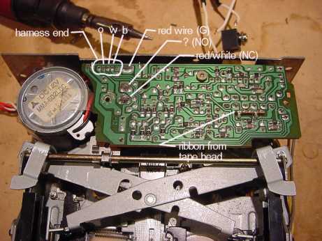

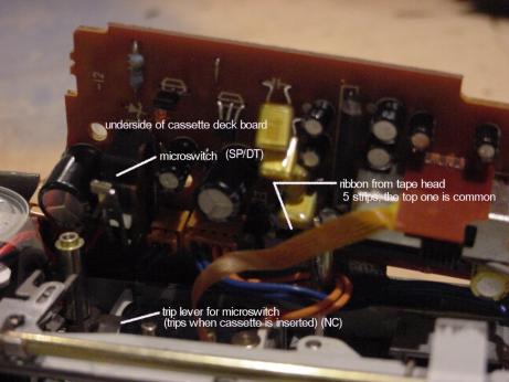

OK, Heres some pics. These are showing the cassette deck and underside of the board on it. The red (R) wire sends a signal or power to the deck and the radio. The red and white(R/W) wire returns a signal to the amp. On the microswitch, the R is on the (G) terminal. R/W is on the (NC) terminal. The R/W wire is connected to nothing else on the board or harness. When the switch is thrown, the R/W is disconnected, the radio quits, and power is sent to the deck thru the (NO) terminal. I spliced into the 3 remaining wires. I think that the brown(B) wire is a ground, and the orange(O) and white(W) are the left and right channel positives. Haven't figured out which is which. If I trip the switch manually,no tape inserted, it cuts the signal and allows music from the CD player to pass thru. But ONLY if I have the 100uF caps on the channels from the spliced in wires. Are you still following me?........ No caps and the signal is too much, and it wont play, it just thumps bad. And I get the hum. And some of the radio sound. With these caps the signal seems to be a tad too weak.

Aux Input for an Older Delco Radio -- posted image.

Also..in the picture you show an spdt switch..and a n/c switch. We can assume the n/c switch is opened when a cassstte is inserted..a no brainer..but what is happeneing with the spdt..once i know this I can guide you to the switching method you can use to perform this function without needing to insert a tape.
