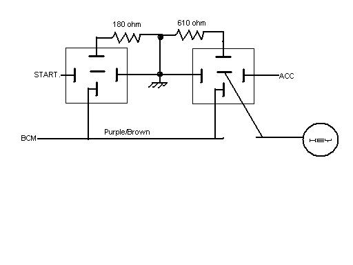

AST is last in line on features, stock up on relays if your installing them07 caliber problem ultrastart 1270t -- posted image..

You said "my 2nd accessory wire on my remote start + into #86 on relay, 87 going to ground with a 610 resistor. i have 85 going to ground 87a going to key side on pur/brn and 30 on the other side
i tapped into the starter + output wire from the brain and tied it into 86,.   ground with 180 resister and 85 ground as well.  and 30 tapped into the pur/brn wire beyond where i cut."
Here's what you describe:07 caliber problem ultrastart 1270t -- posted image.

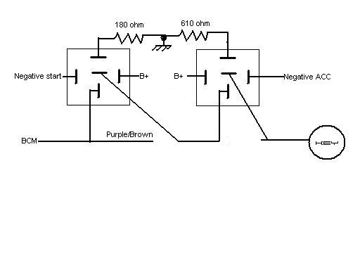

It should be:
