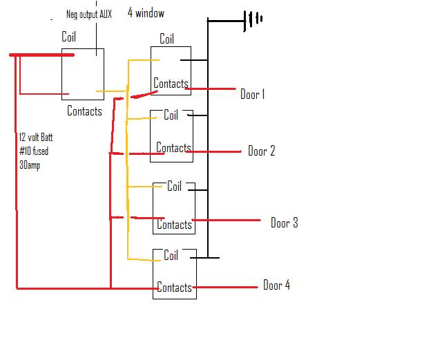

you can also goto a electrical wholesaler and buy relay's with a 12 volt coil N/O type. You will need one relay per window and a aux output of control modul. most units have a AUX neg out rated really low a few milli amps so for this type of system

you might need to add a timer relay in there for to hold the contacts on for the time it takes your windows ti roll down wich would need to be hooked up in seires with the -neg output from AUX i can re - draw if you want.
