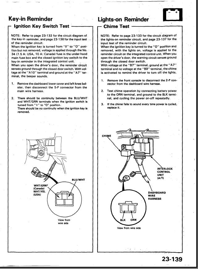

cpgoose
Gold - Posts: 1,098
Joined: July 08, 2002
Posted: January 13, 2007 at 5:20 PM / IP Logged
Hmmm...does this help at all? From the '92 Helms...
