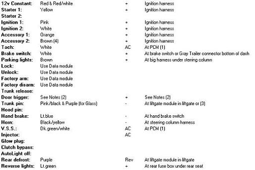

Anybody done one yet??  Are they the same as the 06 models in reference to wiring and locations??  It will be a AutoPage RS600 add-on.  Basically wants it for the RS and keep the factory stuff...so I just need to hit a few wires and use the GM-SL bypass module for the ignition crap I would assume...but thats why I'm asking!!  Thanks guys & gals.

Posted: February 13, 2007 at 7:59 PM / IP Logged
2007 chevy trailblazer remote start -- posted image.

Thank you very much!!!

Thanks for the information.  But according to the above wiring diagram, it shows a starter wire??  So which one is it??  :-)  Thanks!

like all new gms the starter wire is not used( the yellow may be there but serves no purpose) it starts by seeing ignition and accessory, then ignition staying and accessory dropping ( it starts very rapidly)
so, even if yellow wire is there it is not attached to, just insulate your starter output wire and make sure your accessory wire drops during crank

The starter wire will be there regardless, doesn't hurt to hook it up and it does get power when you cycle the key as well even though it isn't required. And yes tach is recommended the charging system usually doesn't kick in right away on this platform. The car will sit at 12.6 or whatever a few seconds longer than it should and some units will shut off thinking it didn't start. It's in the thick harness under running near the steering column, white wire. It will read about 6.5v AC with the vehicle running. And I've seen others say look for the wire that is silver when you strip it, but that is NOT the tach wire. It will be normal copper.

Correct me if I'm wrong PLEASE!!  I have never tested for a Tach wire...always just knew where to go.  But for the test, I take my AC meter, put it on AC Volts, black to ground and red to the wire that I *think* is the Tach wire and it should read the 6.5v AC, is this correct??  Say I get the wrong wite wire...as the diagram above also shows a Ignition wire as a white wire, and apparently in the same harness...will it hurt anything if I hit the wrong white wire while probing for the Tach wire??  Thanks in advance for the help!!

Paul H, you have the correct procedure for probing for a tach wire. If you probe the wrong wire with a multimeter it won't hurt anything.

Most tach wires will read between 1 and 6 volts ac. I believe that NowYaKnow is right that it will be around 6.5 volts ac. As far as how to test for that wire, you are correct. As far as mistaking the the ignition wire for the tach wire, the ignition wire should be 12guage and the tach wire should be a smaller guage, maybe around 18guage. Also the ignition wire will test as DC voltage not ac.
