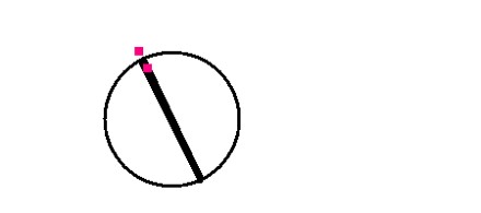

I used fingernail polish to mark the settings on all the gains just so I don't screw my OWN stuff up.  Dab a little spot on a point where the screw line meets the surrounding area. A dab on the end of the screw and a corresponding dab where the screw line terminates.
