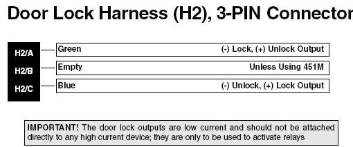

Could someone please help me with instruction of how to install a 350hv in my 2004 Lariat F150 supercrew?
I have the wire diagrams and I have done a lot of searching on this forum.  I have a couple questions about the power lock and unlock features.  The Viper has a Power door lock harness, which is 3 pin.  Is that the harness I use to connect the power lock and unlock switch to?  Green from alarm to pink / YELLOW, and blue to pink/light green?

Door Locks: Yes, just tie the green to the pink / YELLOW and the blue to the pink/light green.
Hooking it up this way will not give you priority unlocking though. When you press lock it will lock all doors and when you press unlock it will unlock all doors, not the driver's first.

I almost completed the install for the viper 350hv.  I did a preliminary test of the lock and unlock button on the remote and the power lock and unlock feature failed to work.
I followed the diagram in my first post and it didn't work as I hoped.  There are factory power locks.  Wanted to use the viper remote to control the locks not the factory remote.
Using the 3 pin, green blue wired to pink / YELLOW and pink/green for unlock and lock.  I picked up the 2 wires at the DKP.
Is there something I'm missing?
The other options worked fine, just having problems with the lock and unlock feature on alarm.
Thanks in advacne.
dkal2980
Member - Posts: 11
Joined: January 28, 2007
Posted: April 21, 2007 at 9:12 PM / IP Logged
Wired the blue and green from the alarm to the unlock and lock connections at the Body control module.
Lock feature is working now.

These colors are for a super duty, the colors you have are correct...pink / YELLOW(-) lock ,pink green (-) unlock.
