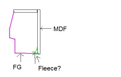

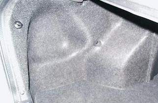

Your explanation helps a bit, though I'm still having trouble visualizing how everything comes together.  I made a terrible drawing in Paint, showing how I see it, perhaps we can take it from there  Right now I envision the FG fitting in the rabbit edge with fleece being attached to both the FG and MDF to finish the seam.  How would you attach the fleece to the FG, just spray adhesive?
Here's my artist rendering.  Is it close to what you're describing?  FYI.. this is a very rough idea of what my enclosure would look like looking through the rear of the car forward.  The second image is a photo of the actual location.

LOL... silly rabbit. First off don't worry about the pain image... those mad art skills are enough for us t ounderstand what you are after.
Now to business:
The fleece covers the entire area that you want ot put glass. In other words, where you have just the FG, it's all fleece with resin. after that has cured, you go back ofer the fleece (in your case on the inside of the enclosure and apply FG to it. The fleece is the base, then you apply FG to that to make it strong.
fg and mdf -- posted image.
The green spots are where you apply duraglass to reinforce the area that meets the MDF. not 100% needed but really helps out a LOT!
