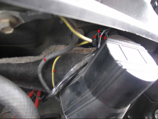

Hate to be annoying, but I'm still a bit confused. Here is an actual picture of what I see. Which wire do I cut?
viper 350hv chirp volume -- posted image.
Thanks.
swamprat323
Gold - Posts: 1,335
Joined: September 22, 2002
Posted: May 21, 2007 at 10:58 PM / IP Logged
untape ALL the wires so u can see them all. waht u will have is
red
black
black wire that is LOOP back in siren
black with a white stripe thsi also is LOOP back int siren
cut the black wire that is LOOP back in siren.

Finally got a chance to try this. Worked perfectly. Thanks!
