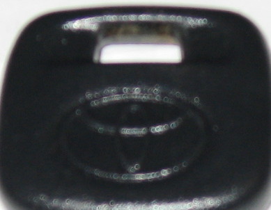

It is extremely rare for a RAV4 to have an immobilizer key. Any way you could post a picture of your key? Do you have a key that is all metal?

2005 toyota rav4, remote start, keyless -- posted image.
The key is all meta,.l no transponder in the key. The black plastice just covers the key

Unlikely that it has an immobilizer .. but if you're unsure, run to a hardware store and make a duplicate of your RAV4 key and try the duplicate in the ignition -- if it starts up, no immobilizer.
