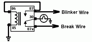

Try this.
One Relay Circuit for each side.
turn signal, brake priority relay setup -- posted image.

My initial thought was this setup may work, then after experimenting with it I found it does not.  Especially not with the bosch relays I have on hand.  There is no delay between the 87 & 87a switching so the brake is the override in this setup.  I'm not sure if there is a relay that has built in delay for this feature.
You may be right in saying this can be as simple as a trailing wiring hookup.  The dodge caravan I have has independent brake and turn signal bulbs.  I want the brake bulb to flash with the turn signal circuit.   You may have seen this in the real world, the brake bulb and turn signals are red which makes it rather difficult to see when trailing these vehicles.  Chrysler/Dodge got smart in '05 and changed it over to one bulb for both brake/turn signal operation.
Thanks for your help thus far, I will continue to research this.

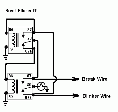

While Driving to work I realized that it will not work. I thought about it all day. I took a couple of hours to analize it.
Here is what I came up with.turn signal, brake priority relay setup -- posted image.
Blinker is hooked to the light thru the bottom relay. If the Blinker is off and the brake is hit the Relay latches to the Break circuit until you let off the break. If you turn on the blinker durring this cycle the top relay will unlatch the relay and allow the blinker to flash.

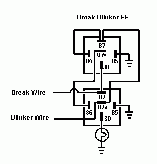

Here is the same circuit with cube relays.

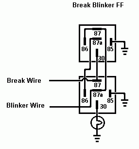

Posted: June 09, 2007 at 12:37 AM / IP Logged
It looks like it would leave the light would on whenever either the brake or turn signal is on; need to tweak the circuit so that the T/S input will interrupt the brake signal when it's on but leave the light off at that time, so it'll blink instead of staying steady on.
Also have to prevent the blinker signal from feeding back into the brake input, otherwise both sides will blink in hazard light fashion whenever the blinkers are on.

Posted: June 09, 2007 at 10:47 AM / IP Logged
Here's a modification that should isolate the two inputs and allow the one side to blink when the brakes are on- basically just turns off the lamp whenever both the brake and T/S are on at the same time, but passes it through normally when only one is on at a time.
