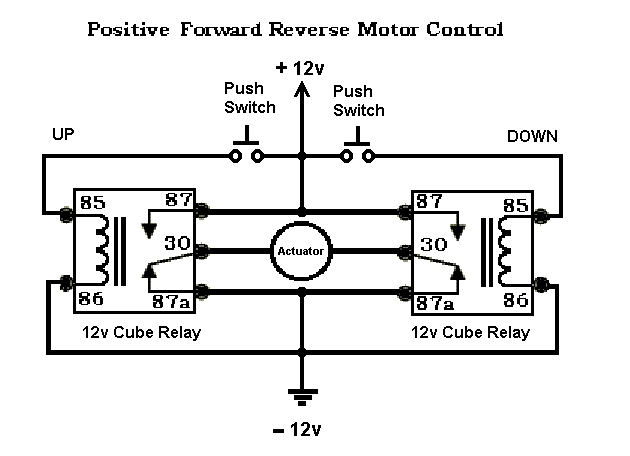

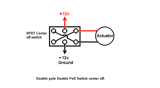

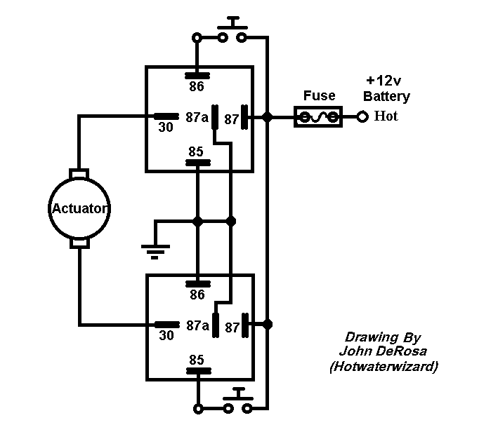

im sorry but i dont really understand the drawing isn't there a way to just use two buttons one up one down I have givin up on the single button method I dont wanna use a hundred relays but what is the best way to do it two buttons the way your drawing looks like I need four out of my remote.

alright ten what are the "remote neg output"  and the "remote pos output" for where do they go?
tuckin-22
Joined: August 16, 2007
Posted: August 17, 2007 at 8:14 AM / IP Logged
ooooooooohhhhhhhhhhhhhhhhh nevermind if your alarm utputs are positive you use te positve setup and one button goes to one side and the other button goes to the other side
and likewise for the negative output
but will it hurt the actuator if it is always gounded on both sides?
hotwaterwizard
Silver - Posts: 1,350
Joined: December 11, 2003
Posted: August 17, 2007 at 8:29 AM / IP Logged
nope it won'[t hurt a thing

tuckin-22
Posted: August 17, 2007 at 8:33 AM / IP Logged
cool i got ya but is what i said correct about the out puts from the alarm
