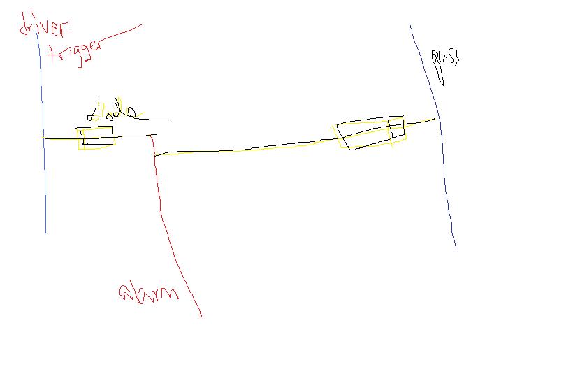

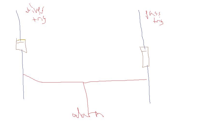

Posted: August 15, 2007 at 8:57 PM / IP Logged
door triggers randomly going off? -- posted image.
Im still kinda lost... I have it like this (or like this http://64.85.6.129/extrainfo/diagrams/840_GRAND-PRIX_(-)%20NEGATIVE%20DOOR%20PIN%20ISOLATION%20CIRCUIT.pdf )
But your sayin do it like this?
Wouldn't that kinda be the same thing? And this will stop the PCM from falsely saying the door is open?

This seemed to work...Followed the 1076 in downloads for fords, been waiting a good 20 minutes now for it to sound off and it hasn't...Just for anyone that reads this..Thanks flash
