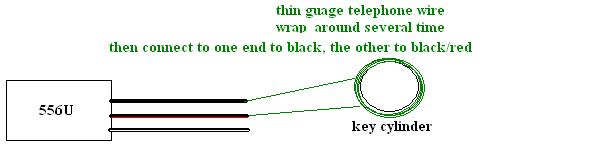

well the visible wires are BLCK/RED, BLK/WHITE and Black. Should I wrap the BLACK/ red around front of key cynlinder?

2000 4runner viper 791 - Page 2 -- posted image.
it should say, wrap the thin wire around the key cylinder several time, then have one end connected to the black, the other end to BLACK/ red.
Dont need to use BLACK/ white
if your alarm is not going off, then its probably in Nuisance prevention mode. just reset the alarm by turning the ignition on then off. read more about it in the manual
your door trigger is correct, dont need to use domelight.

See, I thought I had to have the KEYSENSE wire tapped. BUT now I know. I bet $100 it will work now since I will do that. I have some telephone wire very thin strand. 22-25guage. I HOPE this works.
