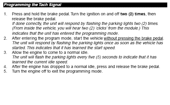

moonliter
Copper - Posts: 322
Joined: February 28, 2007
Posted: November 11, 2007 at 8:06 PM / IP Logged
You can try this.
code alarm f50, 2000 mazda protege -- posted image.
