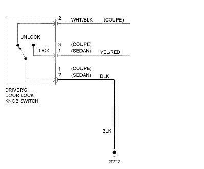

moonliter
Copper - Posts: 322
Joined: February 28, 2007
Posted: December 01, 2007 at 4:28 PM / IP Logged
I found out this schematic for 2001 honda civic, check the yel/red wire with your meter, if it shows neg when you pull the door handle, then you could pulse this wire with the same door lock wire from the rs/alarm diode isolated.
