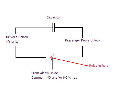

timed or 2 stage priority unlock -- posted image.
Correct me if I'm wrong, but would the circuit work something like this...
The drivers door would open when the circuit was closed from the RKE fob - whether it was held for 1/2 or 2 seconds. Once the button is held down long enough, or until the capacitor was charged, the current would flow allowing the passenger doors to unlock.
thanks,
andrew
