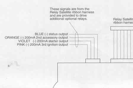

I'm installing a Viper 160XVL remote start unit int o my 2006 Acura TSX.  I'll also be using an idatalink ADS-DLSL-HA.  I'm installed simler rs units, alarms, stereos, etc.  But this oen is a bit more invloved than I thought.  I'm not afraid to tackle it.  ACtually looking forward to the install.  Just tryign to make sure that I have all my ducks in a row.
I've pretty much maped out all the wiring between the Viper unit and the idatalink unit with the exception of the following:
*Ground-out when running
*Starter (+) Input
*Lock (-) and unlock (-)
The viper 160xvl comes with two wires for security arm (-) and disarm (-).  Are these to be used as the lock/unlock wires to connec to the idatalink  box lock and unlock wires?  The XVL also comes with a door lock harnes (DEI 451M), but this has 5 wires not 2.  This is where my confusion lies in with the lock/unlock wire connections.
The XVL has status output, 2nd ACC output, 200mA output, and 200mA 3rd ignition.  Not sure what thes are for.
Any help you guys can offer I would really appreciate it.  :)

1*Ground-out when running
2*Starter (+) Input
3*Lock (-) and unlock (-)
4*security arm (-) and disarm (-)
1)ground out when running (aka status output from XVL) is used to turn on devices such as bypass modules or your idatalink  ADS-DLSL-HA
2)not sure what the starter (+) input is. Are you sure this is not labeled as Starter (+) output?
3)lock on tsx (-) - Pink in drivers kick panel in a GREEN CONNECTOR
unlock on tsx (-) - Light Blue in drivers kick panel in a GREEN CONNECTOR
**note you can only test the wires in drivers kick panel from using facotry door lock switch on passenger side**
4)Security Arm (-) - WHITE/ Red in Driver door in the door molex (plug)
   Security Disarm (-) - White in Driver door in door molex (plug)
* you must remove door panel to get access to these wires*
the security arm/disarm is not your unlock/lock wires. The idatlink should take care of the factory disarm/arm, lock and unlock wires. if the unit does not work, refer to the wiring i left above. The 451m is not required since the doors are just negative triggers. As mentioned before, your idatalink SHOULD take care of locks and factory alarm.
status output is aka GROUND OUT WHEN RUNNING. the 200ma outputs are not required unless u need to drive an extra relay for ignition, acc or starter. From my wiring diagram, it shows u only have one ignition, accessory and one start, so using the ones off the relay pack should be no proble,
good luck, if u have any more questions please ask. ps sorry if i made it hard to undersatnd or lost you along the way.
Ok.  SO, connect ground ground out when running from idatalink to status output from XVL, correct?
Yes I'm sure.  Please look at attached images.
idatalink madule:
2006 tsx viper remote start -- posted image.
Viper relay satellite module:
Viper Main brain box

1)Ok.  SO, connect ground ground out when running from idatalink to status output from XVL, correct?
yes that is correct. the idatalink will be triggered when the remote start is active.
2) start wire input from idatlink
after checking, connect your START wire from START wire on car to this wire. (just tap into wire) its used to disarm ur factory alarm system.
3) Yes.  You're right.  But if you look at the idatalink image it shows this connection happening between the remote starter and the idatalink module.  ????? Remove the door panel?  I was hoping to not have to get into the door.  That's why I bought the idatalink module.  Do I still need to get into the driver door (white & WHITE/ red)  to connect the arm/disarm wires from the XVL to.  If that's the case, then how does the idatalink unit play a roll in disarming and arming?  If the wires aren't connected to the idatalink unit?  That's what confuses me.
no need to go to your door. i only said that if your idatlink module didnt work. Simply connect your lock and unlock wires from the viper unit to the idatalink. Datalink will unlock and lock the doors for you, without having to tap into other factory wires. idatalink should for a fact do all required things for the acura. The idatalink plays a role in disarming and arming with the "START "wire input as mentioned before. when the unit detects that remote start is active (STATUS OUTPUT) and a START signal is sent, the unit tells the onboard car computer to disarm. this ensures the factory alarm will not wail on you.
4)Cool!  So no need to use the 200ma outputs other than the status output which I'm connecting to the ground out when running wire of on the idatalink module, right
That is correct. Cut all other connections that are not used and tape them up good. Just make sure you use the Status Output and wire that to the Ground out when running from your idatalink. Hope that answers all ur questions. Good luck, cheers !
