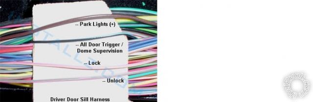

H1/3 Diagram in previous post doesn't show a black wire for whatever reason... So note pic. I should be okay with tapping in there correct?
4206p 00 malibu guide? -- posted image.
Also, having a problem with H1/5 BROWN?
Headlamp switch schematic....
Doesn't show a brown wire in that particular diagram.
But, Front Park/turn and marker lamps diagram... That what I'm looking for? Also stated "***Set for (+)" AS IN? The fuse jumper in the remote start module?
Platinum - Posts: 7,828
Posted: November 16, 2013 at 7:37 AM / IP Logged
Ok.  This might be a very long reply.

6.  While planning and preparation is very important, the goal is to install the after-market accessory in a way that
     will provide many years of trouble-free use, as efficiently as possible.   Most of the engineering of the accessory
     is done and appropriate for the vehicles needs.  The wires are the correct gauge and long enough for most vehicle
     applications.   The axiom of K.I.S.S. can come into play.  Over thinking an issue can impede the install.  The wire
     guide listings available from Bulldog Security and Auviovox generally supply the "tried and true" wires and locations.
7.  One of the most important tools used during the install is the Digital Multi Meter.  Even though you have the full
     vehicle wiring documentation, you should test and verify each wire before making a connection.  Often times a
     connection will be easiest by catching the desired wire in a kick panel or door sill but locating that needed wire in a
     large wire harness with 40+ wires, with several the same color combination, will be impossible without a DMM.
Here is an example from a Ford F-150 of a typical wire harness...
