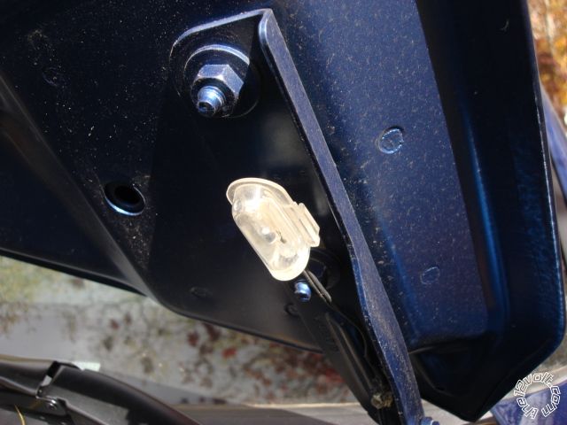

2) Gray (-) Hood Pin Input (N/C or N/O) - connect to kit supplied hood pin switch you installed
- Is this required? I really didn't want to go through the hassle of drilling into the frame of the Jeep under the hood somewhere to install a hood pin kit. I was planning to forego this unless there's a reason it is required or if there is some amazing benefit to it.
A few thoughts on this. First and foremost is safety. Without a Hood Pin input, the Viper could remote start the engine with the hood up and engine repair underway or during an oil change, etc. Most install guides say it's Mandatory but the R/S function will work without it. The next is the 5806V alarm monitoring. Without a Hood Pin input the Viper alarm won't be triggered if the hood is opened. No big deal you say because the vehicle has an inside hood release. Again, it's your choice, one less wire to run... As for the extra hole and rust, there are options there. In a non-alarm R/S install, I use a mercury tilt switch mounted to a hood hinge bolt. No rust and better reliability. Photo below :
2001 Jeep Cherokee, Viper 5806V -- posted image.
