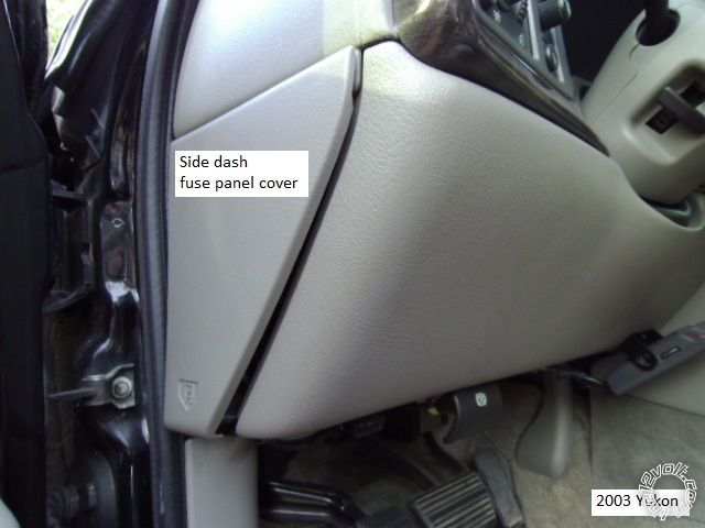

Remove the side dash fuse box cover by pulling it out at the bottom edge.  This will allow easy antenna harness routing
to the windshield.

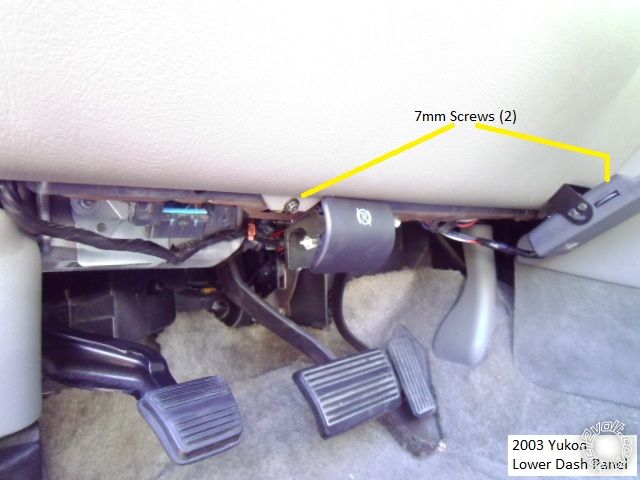

Remove the two 7mm screws shown below and pull the lower dash panel straight away at the top.  There are two clips
along the top edge.

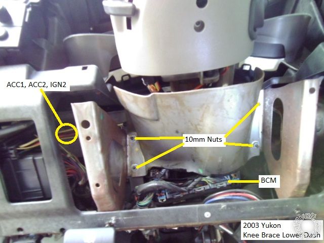

There is no need to remove the steering column cover.  Remove the knee brace to expose the BCM and ignition harness
by removing the four 10mm nuts indicated.

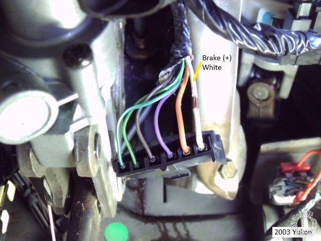

This is a picture of the Brake (+) in the brake pedal switch connector ( unplugged ).  Please note that this brake switch moves
with the pedal and allowances should be made when routing, connecting and securing this R/S wire.
