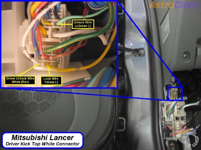

Try this...
door locks on au 2007 mitsubishi evo ix -- posted image.

All the Lancer bodies are the same, I've done UK spec Evos they are identical to Oz except you might have kilos instead of miles and ALL Mits except pre 2000 Japanese spec. Shogun/Montero/Pajero have multipoint neg. switched locking.
If it isn't on the cable loom return from the door, it will be either:
1)On a relay body behind the driver's knee pad to the right of the steering column.
2)Base of fusebox, thin wires, primary black with colours.
Window close however is another kettle of fish, data switching you have to go to each motor.
I would run with Sylvain's diagram.
Test trigger the locks with all doors closed bar the driver's, key away from ignition switch and throw over the locking catch on the driver's door lock mechanism.

I couldn't find 07 but 06 =
Purple to yellow, Lock.
Light Green, unlock.
In driver's door loom.
08 =
Yellow/red, pin 2 lock.
Grey, pin 3 unlock.
Brown plug, driver's kick panel.door locks on au 2007 mitsubishi evo ix -- posted image.
Use one of these, doors closed, key out of ignition, driver's door left open but latch thrown over, croc clip to ground and probe the wires.
