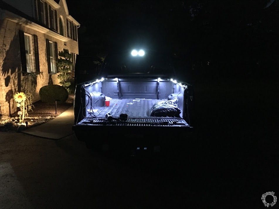

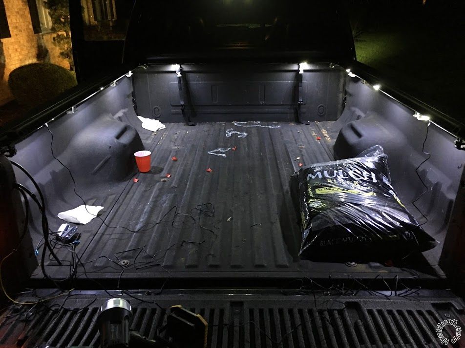

By the way. Here's a pic of the bed lights last night.
Activate Truck Bed Lights from Multiple Sources - Page 3 - Last Post -- posted image.

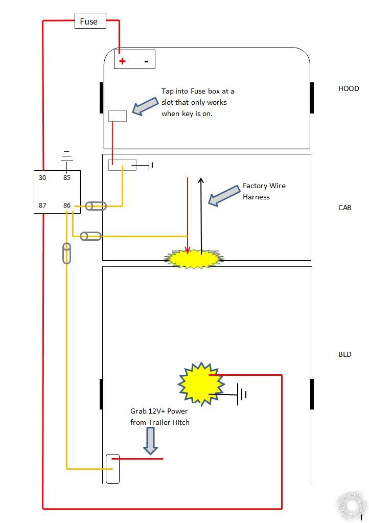

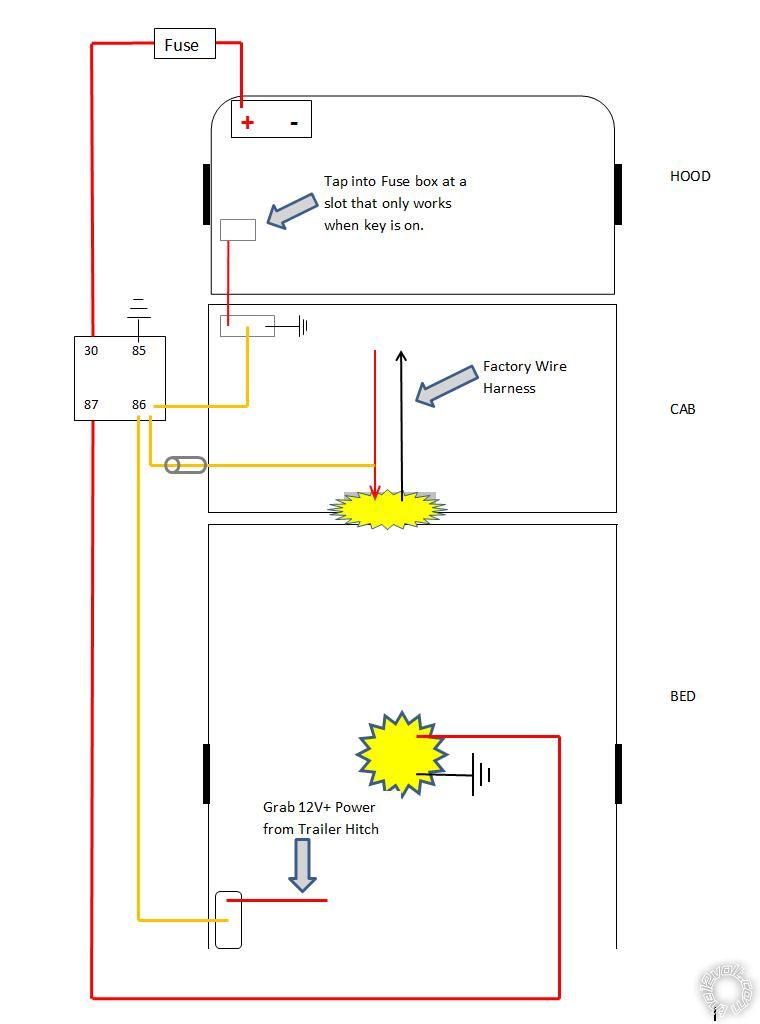

Originally I installed the bed lights with only a diode on the trigger line coming from the factory rear window light as shown below:
But the problem with that was:
That rear window light goes ON under under numerous scenarios even when the truck is completely off, key out of ignition. For example, if I lock or unlock the truck using my key FOB, that light goes on. If I walk up to the truck and open the door, that light goes on, etc. So this is what I noticed. I would open up the drivers door, lights would turn on. Good so far. But if I turned on my dash switch before the delay would turn off the lights, the power would now run BACKWARDS through that switch, into the fuse box (where I tapped in) and activate the entire fuse box. (Follow on diagram above). This caused all kinds of scary things, such as: I would hear the fuel pump under the hood engage, the engine blower motor would go on, the Glow Plug cycle would start (diesel engine).
Said another way; If I turned on my new dash switch while the factory light was on, the truck "thought" I stuck the key in the ignition.
Hopefully that makes sense.
The Solution:
Install a diode on the yellow trigger wire between the relay and the dash switch. For good measure I also installed one on the yellow wire going to the bed switch. I considered installing one on the wire coming from the fuse box to the switch also, to completely control which direction electricity can flow. But I thought this was not necessary as I already blocked flow in that direction from all points of entry. Sure enough I tested it with the news diodes in place and all works well now. So this is what it currently looks like:
