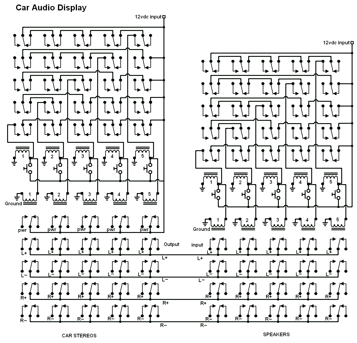

just to switch the relay buttons it will take 25 cube relays, then for the power and speaker outputs it will take 6 for each component that is 30 more and 40 more for 5 sets of speakers speakers that is almost 100 relays to do the job.

OKAY after many hours of thought I figured it out. car_stereo_display.pdf
building a sound board -- posted image.

SoundImage, don't be scared, if you get the relays and post a diagram of the layout of the pins, my picture will be much less intimidating and you will be able to do it. The remote turn on wire from the radios will control the switcher for the radios. You will have to have 4 switches to control the speakers. In the diagram above they appears to be 5 Pole Double Throw relays. You need 4 Pole Double Throw relays to do it the way I am planning.
