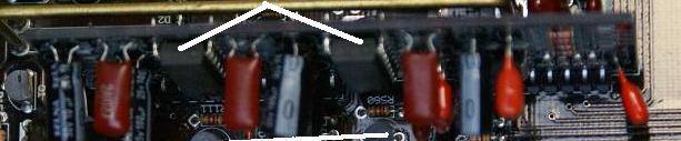

Ok my kind sir, yes we had just about 5v on the remaining power supply transistors. There are two chips that may be the ones your speaking of: They both are labeled S63525A they sit vertically on a separate board. They got 8 pins to each side of them.
pg octane 900.5 repair - Page 3 -- posted image.

I am not worried about the remaining transistors. What is the voltage on the 4 that you removed?   Yes those are the chips I was asking about. If you have 5 volts on the 4 that were removed, we have something else pulling current on the audio section.
