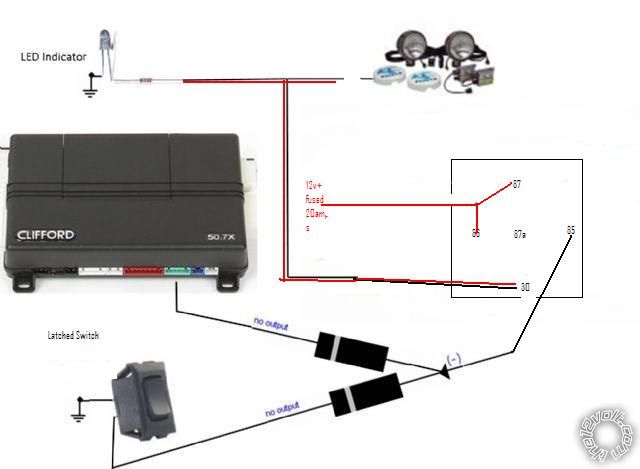

So Like this?? Pin 30 doesn't look right to me.
switch with alarm accessory output -- posted image.
dualsport
Silver - Posts: 983
Joined: September 27, 2005
Posted: October 03, 2010 at 9:17 PM / IP Logged
You show pin 30 permanently connected to ground, so your switches won't do anything. Just remove that connection to ground and it should be okay.

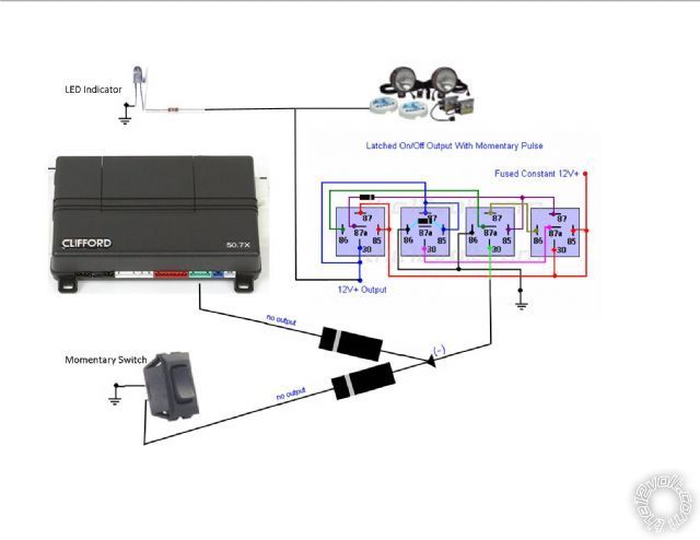

killerbean24
Member - Posts: 8
Joined: July 21, 2004
Posted: October 04, 2010 at 12:58 PM / IP Logged

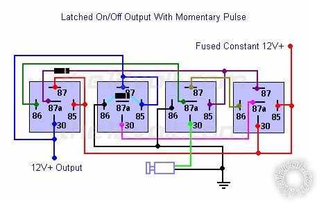

Pin 30 has to be either ground or power, right?
My diagram is based off this diagram on the relay's page...

Posted: October 04, 2010 at 1:35 PM / IP Logged
This is all you need, if you use a latching circuit, how will you turn it off?
Alternatively leave the alarm's output as momentary, keep the momentary switch and feed a 528t or something similar, you7 can then set the time from 1 sec to 5 minutes.
killerbean24
Member - Posts: 8
Posted: October 04, 2010 at 2:03 PM / IP Logged
This doesn't work for my application, because once you send the negative pulse, the relay will only activate for a short period of time. I need the pulse to activate a latched circuit until another negative pulse is sent. My diagram is correct, except I can't figure out if pin 30 on the third relay is negative or positive. It appears to me that 30 needs to be a negative input to energize that relay. I guess I will just wire it up and test it real time.

Posted: October 04, 2010 at 2:16 PM / IP Logged
Forget all those relays and you can set the timing, use a 528t with a momentary switch. The 528t is wired as a normal relay, your latching circuit wont turn off.
30 SHOULD be the pos output from the relay to the lights. Basic amateur problem, you're over complicating things and getting in over your head.

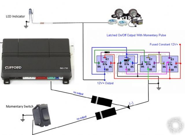

killerbean24
Member - Posts: 8
Posted: October 04, 2010 at 2:45 PM / IP Logged
Nevermind... Rookie mistake! I just wasn't attention to notice that 30 IS the negative trigger, and the others are just ground all the time. Woops. Here is the circuit...
P.S. I am sure the 528t would do something similar, but for me, relays are much easier and cheaper to work with. $1.29/relay vs. $20 for the 528t.
