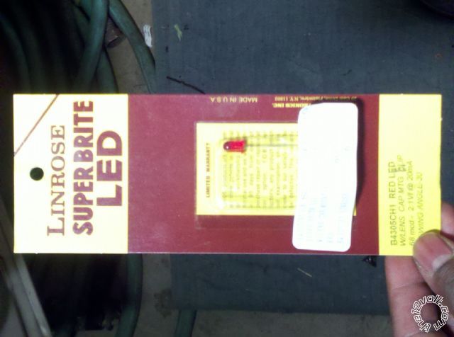

Posted: December 31, 2010 at 5:16 PM / IP Logged
calijtee1,
I tried that and still the same result. This is a photo of the led i'm using. Any other suggestions?
very dim led's -- posted image.
Pass on what you have learned - Yoda
skywatcher2001
Member - Posts: 37
Joined: August 17, 2010
Posted: December 31, 2010 at 5:22 PM / IP Logged
I wired the LED's (+) directly to 12v Fuse Box and the (-) went to a single lead from the Viper Module. I tested it with a volt meter and there was nothing. However it blinks when the alarm is activated but very dimly. The other lead from the Viper shows 6v but I am not using it at all.
