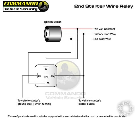

The harness from the Viper system only has one thick starter wire (violet i believe). In order to get your car to remote start, you would have to power up both starter wires (BLACK/ white and black)at the same time. You would need to use a relay to power up that second starter wire while the main Viper harness powers up the primary starter wire.
2007 toyota highlander, remote start -- posted image.
The only thing I would change is connecting Pin 86 directly to ground instead of using the "ground out when running" wire as that one might be used for the immobilizer bypass.

No, the proper way is to do this with the Ground when running wire. Otherwise you're triggering the relay every time that you start the vehicle with the key.

Thank you zerepdivad, I didn't realize that. I'm sorry for suggesting to do it that way.
