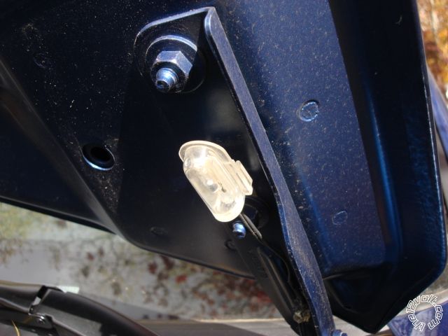

Use them all the time.  Here is a "no holes drilled" way to install.
mercury switch, magnetic reed switch -- posted image.

nice,do you mind if a borrow that idea?
Platinum - Posts: 7,827
Posted: October 08, 2012 at 10:08 PM / IP Logged
Please, help yourself.   I'm sure this was install method was done long before I thought of it.   In the spirit of sharing, if you clean the metal area of the hood support hinge well, you can use a squeeze or two of hot-glue to secure the wires from the switch so they won't get damaged and stay neatly out of sight.  mercury switch, magnetic reed switch -- posted image.
