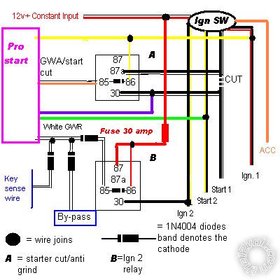

Some answers NOTE the Camry and Maximas were taken out of the Euro market in 03, killed by BMW and Audi so I'm not au fait with them, also don't know this make of alarm.
WHITE/ green and WHITE/ brown not needed factory arms and disarms with lock/unlock
Factory blue key sense need this connected as in the Wooohooo post post blue connect to GWR wire see diagram.
My info is that BLACK / YELLOW is either 2nd starter or second ignition, test for which, both need connecting.
Apparently on 3.0 litre models it goes to the ECM behind glove box BUT if you have a BLACK/ orange wire at pin 9 on the data socket (OBD ll)that will be tach.
Dome light is NEG (-) the Camry already has dome supervision so find the lead on the dome light that switches to negative when you open a door and brings on the light. Follow it back to the fuse box and connect your negative door trigger to it.
White GWR, yes also see diagram.

Here's your layout diagram. Program GREEN as second starter:-

Nice post BUT as per my diagram, TWO starter wires on the Camry,  ONE on the Corolla.
