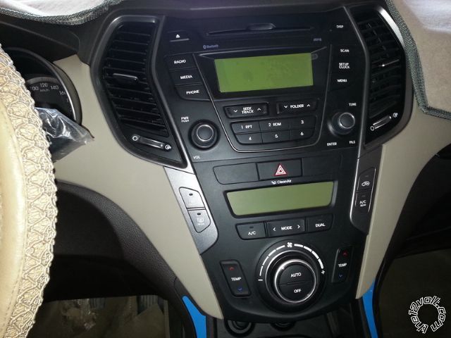

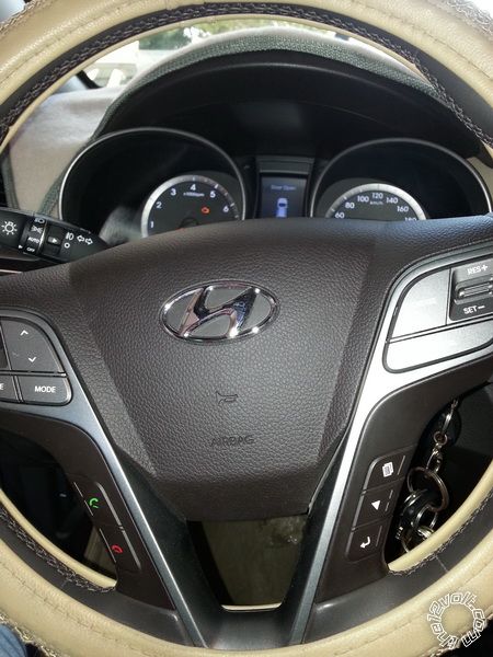

Hello,

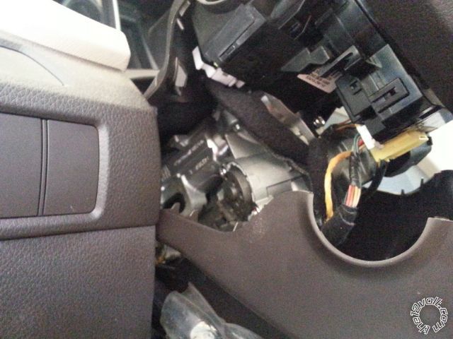

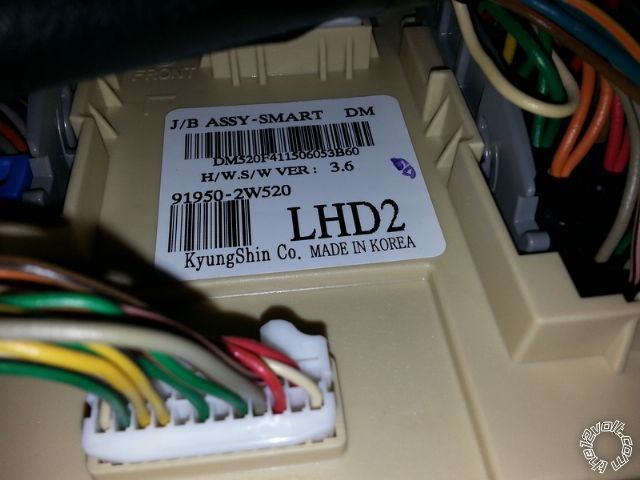

I am planning to purchase R/S ( Viper 5706v ) to Santa fe 2013 ( Middle East version), I am just wondering if this unit ( viper 5706v ) compatible with Santa fe 2013 or not , and does it required a bypass? which Module ?

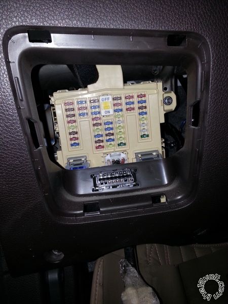

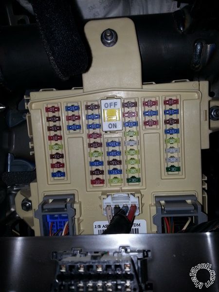

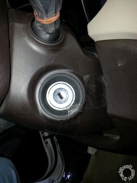

also I will post some images regarding this vehicle.

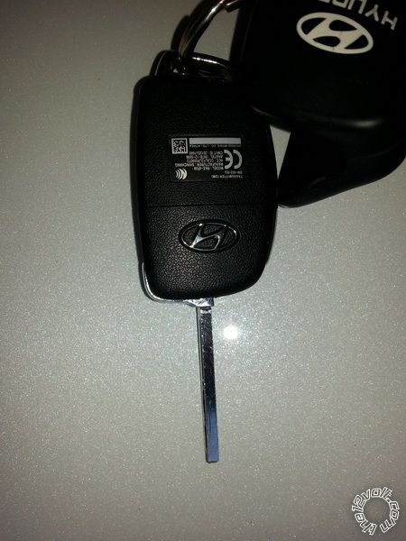

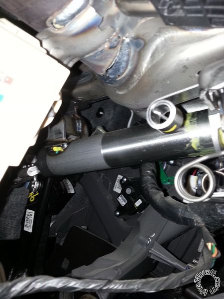

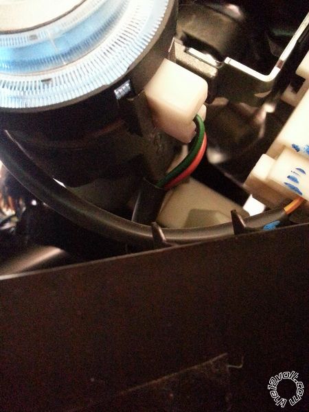

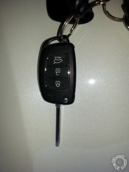

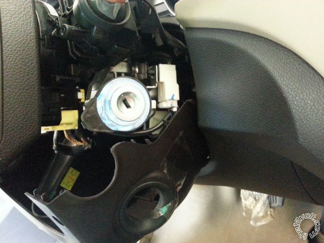

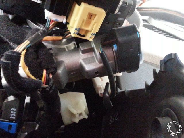

For your vehicle I believe it was optional and less it was the sport addition. Looking at your key it looks like the transponder key for the Santa Fe. The only two ways to know for sure our number one either order or go to a dealer that has a transponder tester and test your key. . Also if you take apart the steering column just the plastic paneling around the key cylinder you should see a transponder module if it's equipped if it's not equipped you will only see the steel casing of the key cylinder.

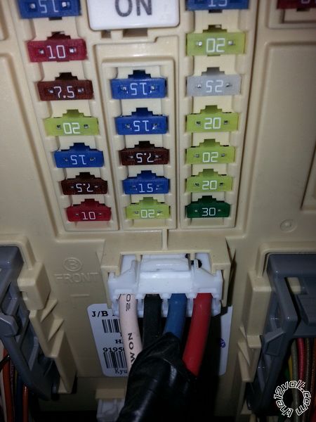

Posted: November 02, 2014 at 2:30 AM / IP Logged Link to Post Post Reply Quote wissam1981

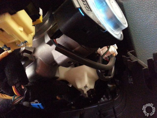

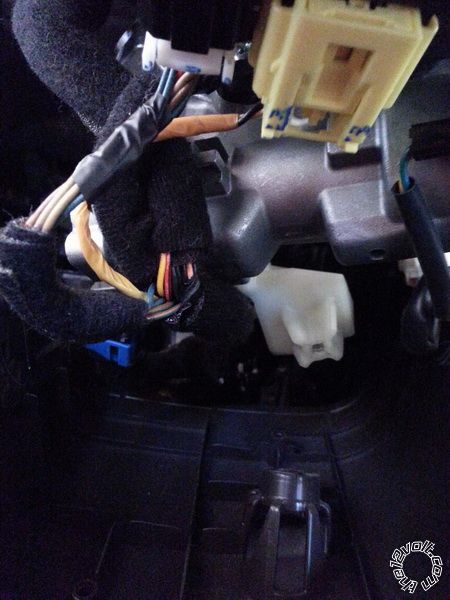

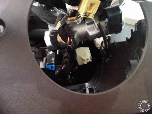

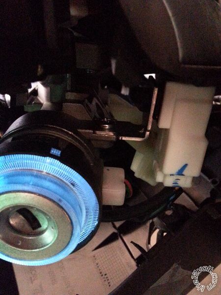

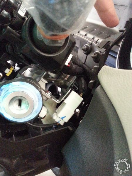

Hello,
Check this out guys, i Need your advice.

tonanzith
Gold - Posts: 603
Joined: July 18, 2008
Posted: November 02, 2014 at 10:30 AM / IP Logged Link to Post Post Reply Quote tonanzith
Yes that has immobilizer.
