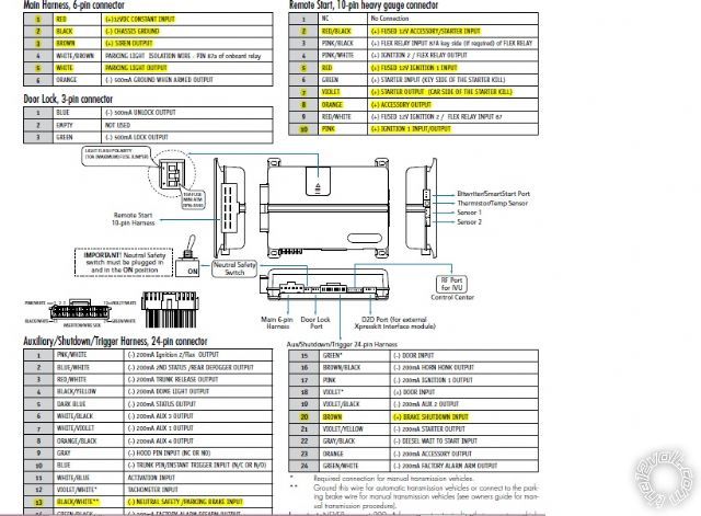

Guys i have one question please
regarding the car starter wire
in the viper guide there are 2 wires
6 GREEN (+) STARTER INPUT (KEY SIDE OF THE STARTER KILL)
7 VIOLET (+) STARTER OUTPUT (CAR SIDE OF THE STARTER KILL)
my question is
1- should i cut car starter wire and hooked up the 2 wires in the viper as guide said ????
2- Or just hooked up car starter wire to VIOLET (+) STARTER OUTPUT ???

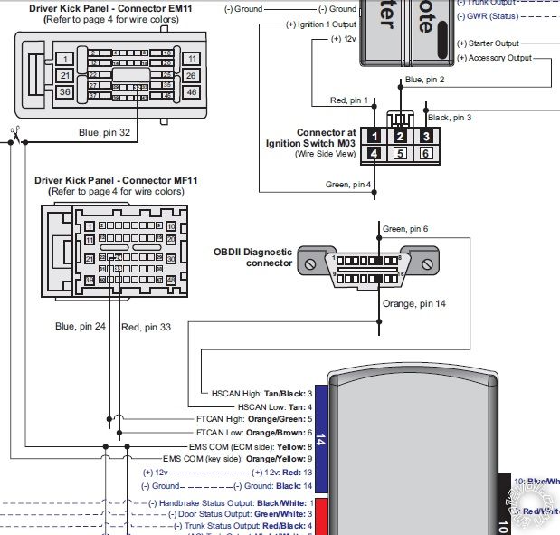

Also, i attached this image of what wires should be connected.
viper 5706v for santa fe 2013 - Page 2 -- posted image.
Posted: January 04, 2015 at 6:35 AM / IP Logged Link to Post Post Reply Quote howie ll
First answer is safer (anti theft) second answer, easier.

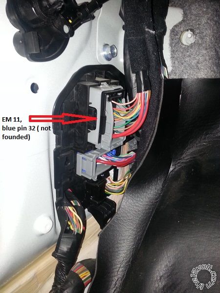

firstly I appreciate your efforts to help me , actually I completed installation my device ,but only one wire couldn't found in vehicle in EM11 driver kick panel which is blue ,pin 32.
i completely finished all wiring expect the wire in the EM11 ( blue, Pin 32 )
therefore, i couldn't connect the following wires
EMS COM Data ( ECM side )yellow/black
EMS COM Data ( ECM side ) ORANGE / black
EMS COM (ECM Side ) yellow
EMS COM (Key Side ) orange yellow
My Question is, what this wires do, what will happened if didn't connect them??
Thanks alot
Viper 5706v
bypass :DBALL2

Maybe for the immobilizer, that you don't have.     Have you completed the installation?

I am already completed installation (viper and bypass) and the vehicle has started normally with the said devices and remote also working normally, but I am still confused about the blue wire in pin 32 practically did not founded but it is in the installation guide... what is your suggestions ?
daflipcyde
Copper - Posts: 68
Joined: October 28, 2006
Location: Manitoba, Canada
Posted: January 12, 2015 at 12:47 AM / IP Logged Link to Post Post Reply Quote daflipcyde
That blue wire will only be there if your vehicle has an immobilizer. Since your vehicle does not have an immobilizer you can skip that and it should start.
