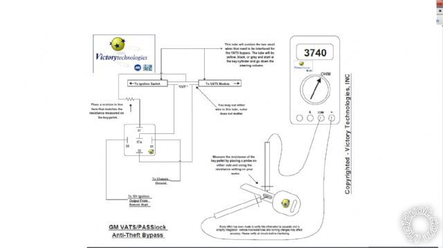

I know this sounds dumb, but check the value of the resistor, and make sure its within tolerance. A failed resistor will cause this problem. Car Stalls After Starting, Python 1400xp - Page 2 -- posted image.

Thanks for the diagram. I will check it out tonight. Would you happen to know what the tolerance should be for the GM key?

Posted: December 19, 2014 at 10:11 AM / IP Logged Link to Post Post Reply Quote dcman41
its different for every car i believe. In that diagram it shows you how to measure and retrieve the correct resistance.
