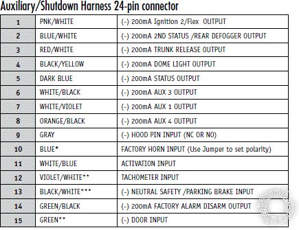

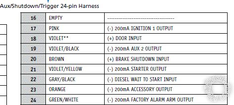

Any other wire that need to be connected from the connector bellow. I will connect everything tonight if possible.

smokeman1
Platinum - Posts: 1,589
Joined: September 14, 2009
Posted: March 16, 2015 at 12:22 PM / IP Logged Link to Post Post Reply Quote smokeman1
The D2D takes care of the Ground for the power to the DB-ALL.
Not the ground for the Viper unit OR the BLACK/ White Safety ground. If an automatic transmission BLACK/ White MUST BE GROUNDED. Along with the black ground from the 6 pin harness.

Posted: March 16, 2015 at 7:37 PM / IP Logged Link to Post Post Reply Quote cherxiong
Thanks all.....It works after I grounded the BLACK/ White wire. I didn't change any connection that I have made on page 9. I didn't have to have the key sense connected to the dark blue wire, Howeii...Thanks for helping from the beginning to the end.
