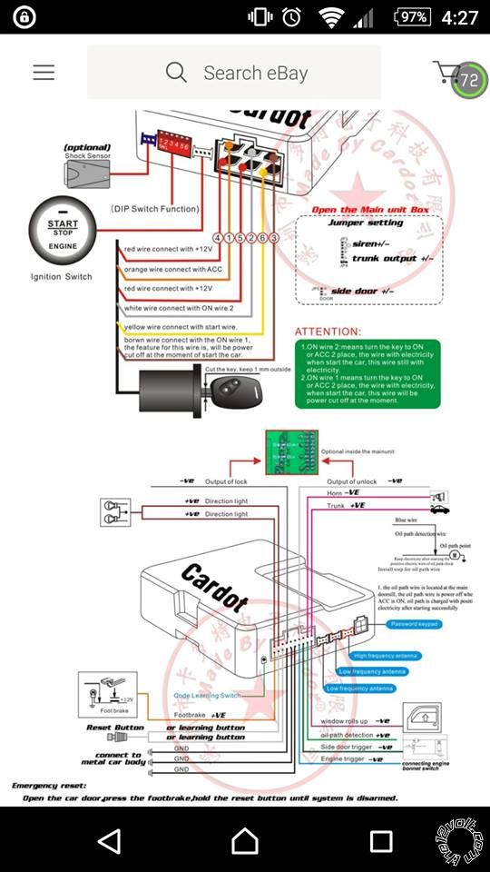

This is the Diagram

looks like the window roll up output is for 6 sec, unless I'm looking at the wrong manual. But, how do you engage the window roll up output? Do you have a manual that explains the features otherwise you'll have to deal with tech support.

Thats the only diagram. Its say only if i press lock the window roll up.

Based on the info, you'll have to tie the (-) window roll up wire to the Accord's Factory Alarm Arm wire in the Driver's Door. In theory, based on the info, when you hit lock on the remote the factory alarm arm wire in the Accord will see a ground pulse for 6 sec and roll the windows up.

I tried to connect the Cardot window roll up output from factory alarm arm but no luck. It should roll up?

It should roll up if you can trigger the windows with the key in the driver door cylinder. (Test) With the Windows's down and the doors closed (make sure the drivers door switch is plugged in) take a jumper and tie one end into the factory alarm arm wire and take the other end and hold it to ground. Do the windows roll up? If so, the cardot output isn't engaging on lock or you need a relay because the output doesn't have enough current to power the circuit
