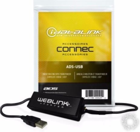

The ADS Blade cartridge is a module that is designed to cover many functions for many vehicles. It is flashed with
specific firmware that sets it up to interface with a specific vehicle in a specific way. There are hundreds of different
firmwares that can be flashed on to the module. Your 2013 Subaru Outback needs the ADS Blade-AL(DL)-SUB3 firmware.
The process of flashing the Blade cartridge is as follows :
1. Insert the Blade AL cartridge into the Compustar CM700as slot.
2. Plug the ADS USB cable into the correct 4 Pin port CN7.
3. Plug the ADS USB cable into your PC and sign on the ADS's WEBLink site.
4. Wait until the site recognizes your CM7000as and Blade cartridge.
5. Select your vehicle and flash the firmware.
At this point you can configure the Blade module and certain programming features on the CM7000as module.
Next you would disconnect the CM7000as from the ADS USB cable and plug in all the connectors necessary for your
vehicle install. Next comes inserting the fuses and programming the Blade to the vehicle.
Part of the vehicle programming process has you disconnect all the harnesses on the CM7000as and plugging
in the ADS USB cable for the KLON process. KLON is what makes a copy of the transponder chip info and writes
it back into the Blade module for use during a remote start.
Photo of ADS USB cable :
2013 Subaru Outback Compustar 7000as Blade-al -- posted image.
Is this what you are doing?
