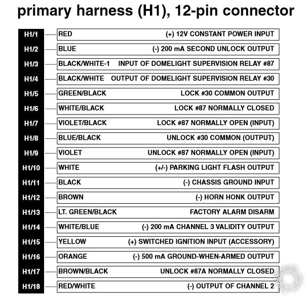

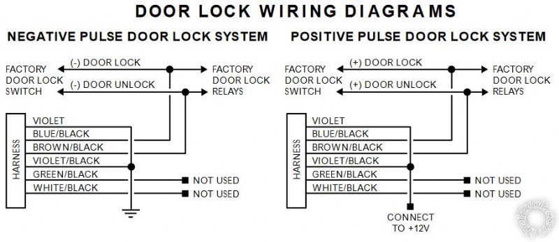

I really need some serious. I mean serious... help with this as I did everything logical so I thought. I am totally lost with this and hope anyone out here is willing to help me.
Nothing happens upon pressing key fob after making the actual harness connections to my Lock/Unlock truck wires using the selected (on right) "positive pulse door lock system" diagram below.
2004 F-250 Super Duty Viper 211HV Pls - Page 2 -- posted image.
Viper Model 1211HV Harness (Below):
How I connected to my truck without success:
Important Note #1: First I must make clear because I'm adding other 12v accessories besides this keyless remote system & decidedly ran 12v direct from my battery to a fused terminal under my dash to accommodate all my accessories & to avoid tapping multiple 12v accessory connections into the ignition harness.
I hope this is acceptable but since I'm not an electrical expert or engineer of sorts The viper Model 211Hv harness as seen above has a solid red 12v wire with an inline 15a fuse and I was required to use another fuse & chosen another 15a fuse to be able to utilize the terminal connection. If this is part of my problem (having (2) 15a fuses within the same connecting 12v wire & why I can't get the locks working I sure would like to know.
Important Note #2: The Violet wire (Unlock #87 Open Input) & Violet/Black wire (Lock #87 Open Input) wire from the Model 211HV harness diagram above are shown being separate wires in the listed diagram however in front of me looking at the actual harness they're indeed separate but adjoined together connecting within another same inline 15a fuse but both wires ending in 1 single connection. I also connected these wires to my 12v terminal with another additional 15a fuse to again utilize the terminal connection and more notably important the 15a fuse in the terminal with this particular connection blown immediately twice upon each attempted remote key fob test after I made all connections. Obviously something not right here. So overall (4) 15a fuses or (2) 15a fuses on ea. connection. Is this a problem and why I keep blowing a fuse on the terminal with the violet & violet/black wires and I can't get power locks to work with key fob ???????? I have no clue. The fuse on red wire never blown so noted.
The Other Simultaneous Connections I Made With The Noted 12v Connections Above Attempting the Unsuccessful Remote Key Fob Lock Test:
  • GREEN/ Black #30 Wire (Model 211HV) was connected to Pink / YELLOW Lock Wire Truck
  • Blue/Black #30 Unlock Wire (Model 211HV) was connected to Pink/LT Green Unlock Wire on Truck

I also want to make known I performed a key fob test of the actual Viper Model 211Hv unit to ensure the unit itself isn't the problem.
Having the harness plugged into the unit & connected to 12v and my multi-meter while pressing a remote key fob:
GREEN/ Black Lock #30 Common read a proper 12v
Blue/Black UnLock #30 Common read a proper 12v
That establishes having the unit's #30 Lock/Unlock common wires connected to my truck's power lock wires indeed were sending the proper juice and should of easily had my power locks working remotely with the unit naturally by pressing the unit's key fob but again for whatever unknown not happening.
