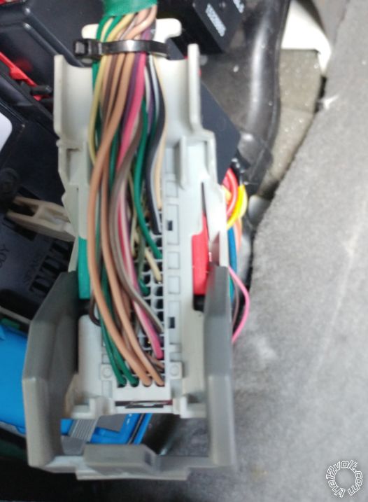

Pin 5 is brown/white and i'm using it for the parking lights like the doc says (so I know I'm on the right connector).
But the keyless data pin 12 is empty on my car. Nothing I've found covers this problem :/

The car didn't come with factory keyless so this method won't work. You will need to hardwire lock, unlock, disarm and trunk from the 4105 to the car.
