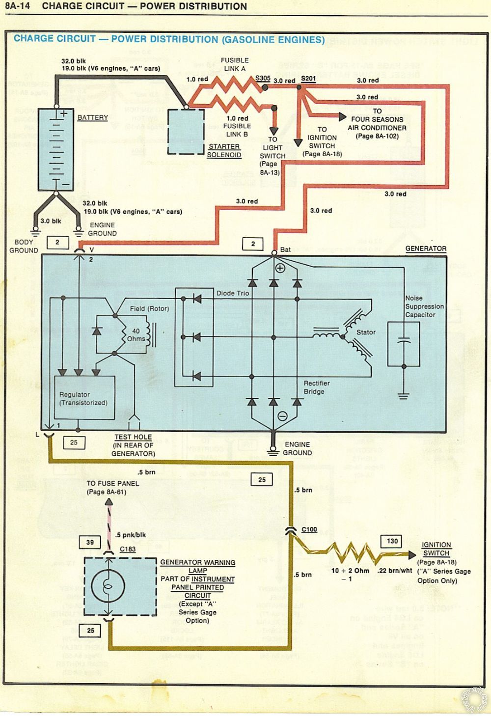

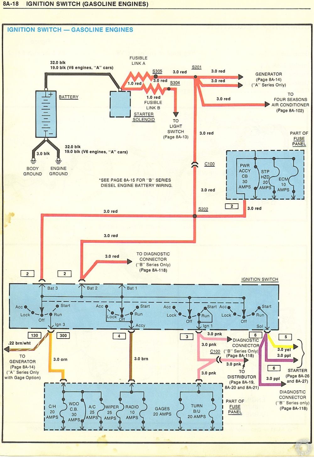

I've attached the factory wiring diagrams for the ignition switch and charging circuit. It shows there are 2 ACCY wires:
... Brown = wipers and radio (don't need this)
... Orange = Choke Heater (C/H), power windows etc. (WDO) and AC (want this one)
Thus connect orange at switch to orange (Viper H3/3) on brain. Correct?
Then on ign. switch diagram there is a brown/white wire that goes from ign. switch to "generator". I believe this is the wire currently attached to the CS130 alternator "L" pin. Will verify when I wade into the abyss under the dash. Given there is no warning light (replaced with a voltage gauge), there is a resistor in this wire to substitute for the lamp resistance.
If the above is correct so far, to activate the "L" wire, would the "Viper Remote start auxiliary output, 5-pin connector, Pin 2 Orange (-) 200mA Accessory Output" be used with a SPDT relay? If so, would really appreciate your suggestion as to 85,86,87,30 connections. Or is it acceptable to put the "L" wire on the Viper H3/3 Orange Accessory Output along with the accessories? Or other options?
EDIT TO ORIGINAL POST: Could "H3/7 Pink/White (+) Ignition 2 / Flex Relay Output" be used for "L" wire by programming Menu 3=Remote Start, Item 8=Flex Relay Function, Feature 2=Accessory. Wouldn't that activate it only during run and not cranking?
Thanks in advance for your help!!!
PS -- Is it normal for fuel gauge to show Empty (apparently shorted to ground) when the parking lights are flashed? That's also happening.
