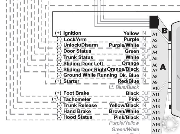

I'm still confused. If you are using a full featured bypass module that handles the caravans door locks and supplies you with a good Tach signal, why do you need to know their location in the van. Below is the wiring diagram for the Fortin EVO-ALL bypass module :
2008 Dodge Grand Caravan, Remote Start Install -- posted image.
Lock is the Purple wire at Pin A2
Unlock is Purple/White at Pin A3
Tach is at the Pink wire at Pin A12

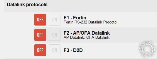

If Code Alarm systems only support Flashlogic bypass modules which use the DBI protocol, then you would need to set the EVO-ALL Option F3 as shown below :

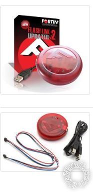

This is done using the Fortin FlashLink2 cable pictured below :
