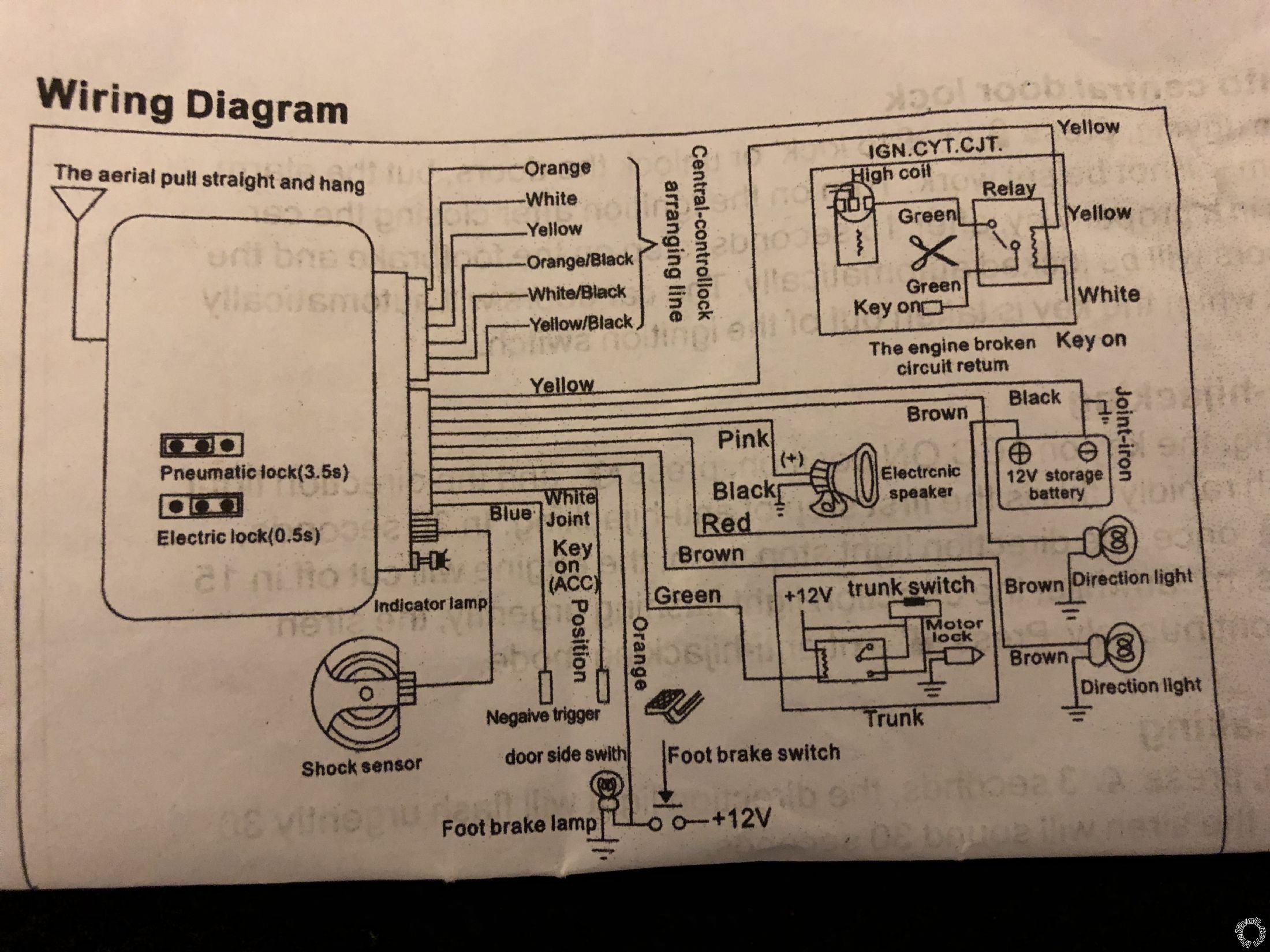

Posted: March 02, 2019 at 4:49 AM / IP Logged Link to Post Post Reply Quote chev104275
Can you post the wiring f that came with the system ? I would assume if it came with the actuators the diagram would show you how to wire it.

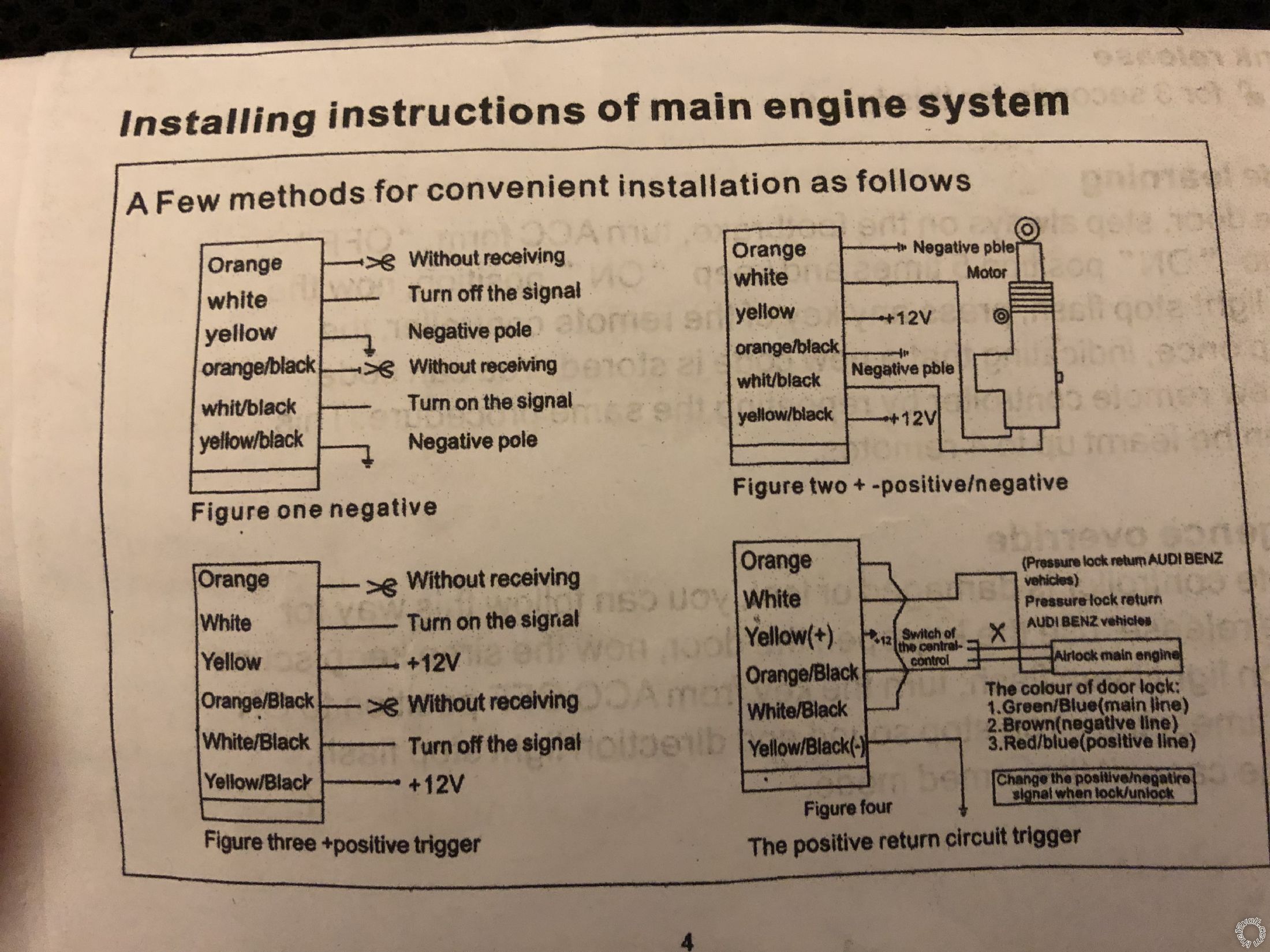

Posted: March 03, 2019 at 7:40 AM / IP Logged Link to Post Post Reply Quote horacecain
I Only Want to Connect/Use Keyless Entry/Exit -- posted image. I Only Want to Connect/Use Keyless Entry/Exit -- posted image.

Platinum - Posts: 13,725
Posted: March 03, 2019 at 10:43 AM / IP Logged Link to Post Post Reply Quote i am an idiot
For the door lock portion you need to use figure 2 for the wiring. You do not need to use the relay diagram provided earlier, that diagram is built into your alarm system.
If you are not using any of the alarm features you will connect only the Black Brown and White wires of the system.
And the wires for the door actuators.

Posted: March 03, 2019 at 11:20 AM / IP Logged Link to Post Post Reply Quote horacecain
Thank you,
Ok refresh:
WHITE goes to Positive source.
BLACK to Negative source.
Where does BROWN go?
If I understand correctly, the driver door actuator has 5 wires on it and is the “master” the other units have only 2 wires, how do those connect to each other?
I appreciate your help and time.
mr
Posted: March 03, 2019 at 3:16 PM / IP Logged Link to Post Post Reply Quote i am an idiot
Brown goes to constant 12 volts. White to an accessory or ignition power source.
Does the 5 wire actuator have a blue and a green wire? If so, use those 2 wires only. Connect all the blue actuator wires together and connect all the green wires together. Wire those as shown in figure 2. White to Blue. White/black to green.
You should also connect the parking light wire so you can count light flashes to make sure it locks from a distance.
If the locks operate backwards, reverse green and blue.

Posted: March 07, 2019 at 3:12 AM / IP Logged Link to Post Post Reply Quote horacecain
Once again, thank you for your direction.
Unfortunately the actuator will not operate. I tried reversing the white & white/black also, no movement from the actuators.
I suppose there are other wires that need to be connected to something.
