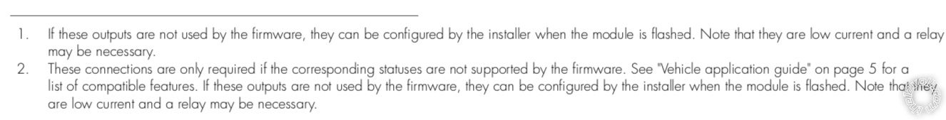

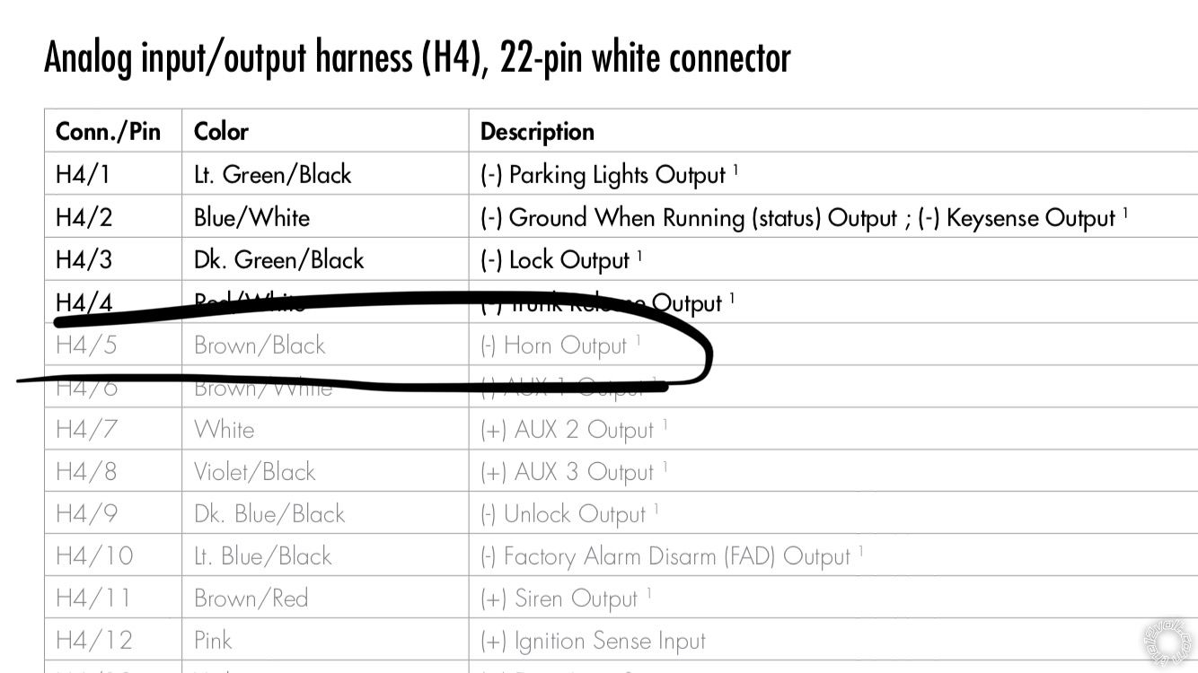

I have never installed these nor am I directed authorized dealer but in perusing the install guide, it appears that the horn function is predetermined by the firmware for each particular vehicle. I think horn outputs are not enabled by default and therefore it has no signal output on that wire. Perhaps that option could be check marked in the firmware upload tool by the dealer according to the footnote for that output in the install guide. I have no way of knowing that though but if it is possible then that seems like the most logical approach to enabling a horn output that is not on by default for your vehicle. If they are able to enable the output, it would require a relay to pulse the vehicle horn wire as the DS4+ output is very low and directly connecting it would probably overload and blow the output.
Perhaps a directed dealer that has used these units may be able to offer more guidance. I would suggest trying a different Best Buy or another local directed installer to see if they may be able to help you. I uploaded the guide and linked it below for your reference. Good luck.

Here is a link to the DS4+ with Niss1HT firmware install guide for your truck :
https://directechs.blob.core.windows.net/ddt/933-NISS1HT-4.14.193_2015-Nissan-Frontier_IG_EN_20190304.pdf
As you can see from the wiring diagram on Page 7, Directed does not show a Horn connection.   I image that
there is an output that does perform that function but it is not listed in the harness listing on Pages 10 - 12.
Assuming that Best Buy is an authorized DEI installer, they should be able to contact their own Tech Support
or DEI Tech Support to get assistance. I would expect an additional charge for this extra work you desire,
similar to the extra charges for window roll-up / control.
Seems like they call the White 22 Pin harness H2 in this application, not H4. Either way, it looks like the
Brown/Black wire at Pin 5 is the answer.   But as Steve points out, it might need to be programmed on the DS4+
to work.

Hi, the brown/black is the correct wire to connect and it’s always “on” by default in all firmware. For it not to work is because the installer turned it off. And yes, it’s a full horn and not a muted horn. A Directed installer can easily connect on your module via Bluetooth and turn it on. It take 20 seconds to do so.
