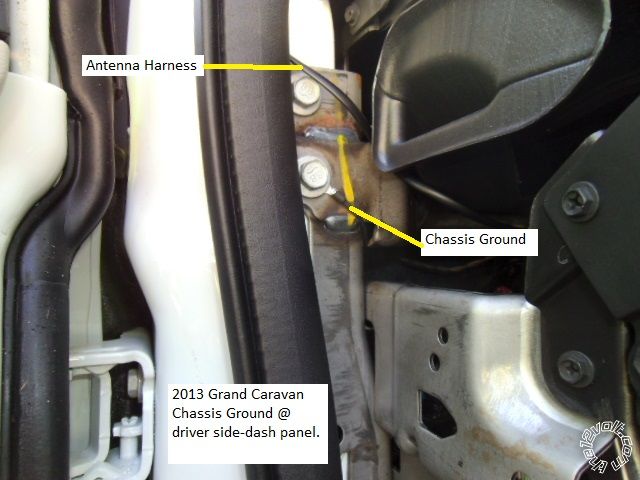

The Chassis Ground connection should be via a soldered on terminal ring going to solid rust and paint free metal frame. Think you mentioned getting a false GWR signal from the R/S at one point so making sure the Chassis Ground connection is solid might be a good idea. This Chassis Ground supplies the (-) output for things light door locks and Parking Lights. One possible connection point shown below :

10-4 just got in from work. I'll verify the wiring and solder the all the joints. Minus the ground which has ring terminals. Give me a few and I'll get back to you.
