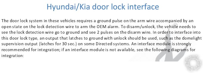

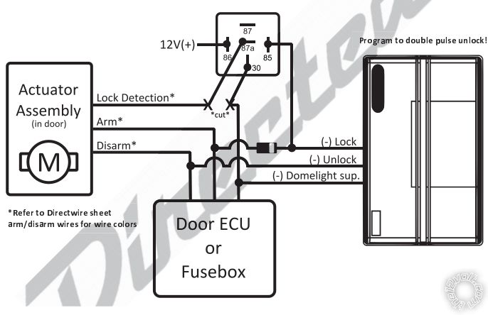

I did notice one thing tonight, which is strange, the OEM key fob will not function if the car is remotely running, and occasionally the Prestige transmitter will not unlock the car, like its gone to sleep or something, I cannot hear the brain relays click, so I have to unlock the car door manually which sets of the horn/alarm, I didnt think this car had an alarm, I have hooked up the 15 Black w Blue trace Wire: Pulsed Ground Output Before Start to the Factory Alarm Disarm Pink wire and it still has this issue, I was reading the forum and read a forum post concerning "see Tech Doc 1300" I also found this note in the wiring diagrams section, I downloaded this tech sheet, Hyundai/Kia Door Lock Interface, if your not already familiar below is what it states and the diagram.

So for the 2015 Kia Forte5 is this something I need to do?

Have you looked at the pictorial for the 14 Forte ? I've done a ton of those cars and I've never done that doc.

Mickb24-
As Chev posted, that doc is not necessary. Here is the link to Chev's excellent pictorial--https://www.the12volt.com/installbay/forum_posts.asp?tid=135901
This is for a 2014 Forte, 2015 is the same.
