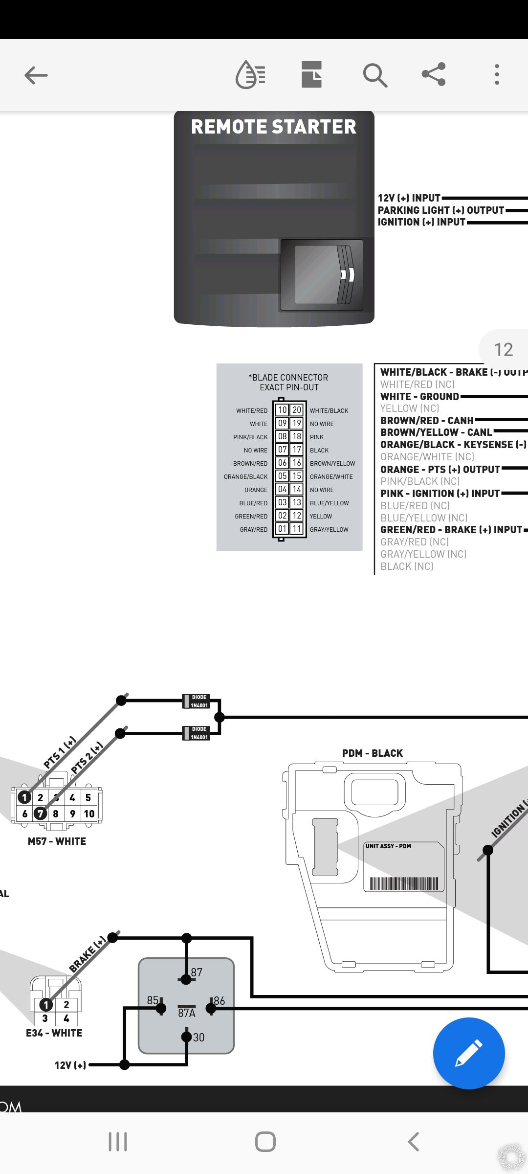

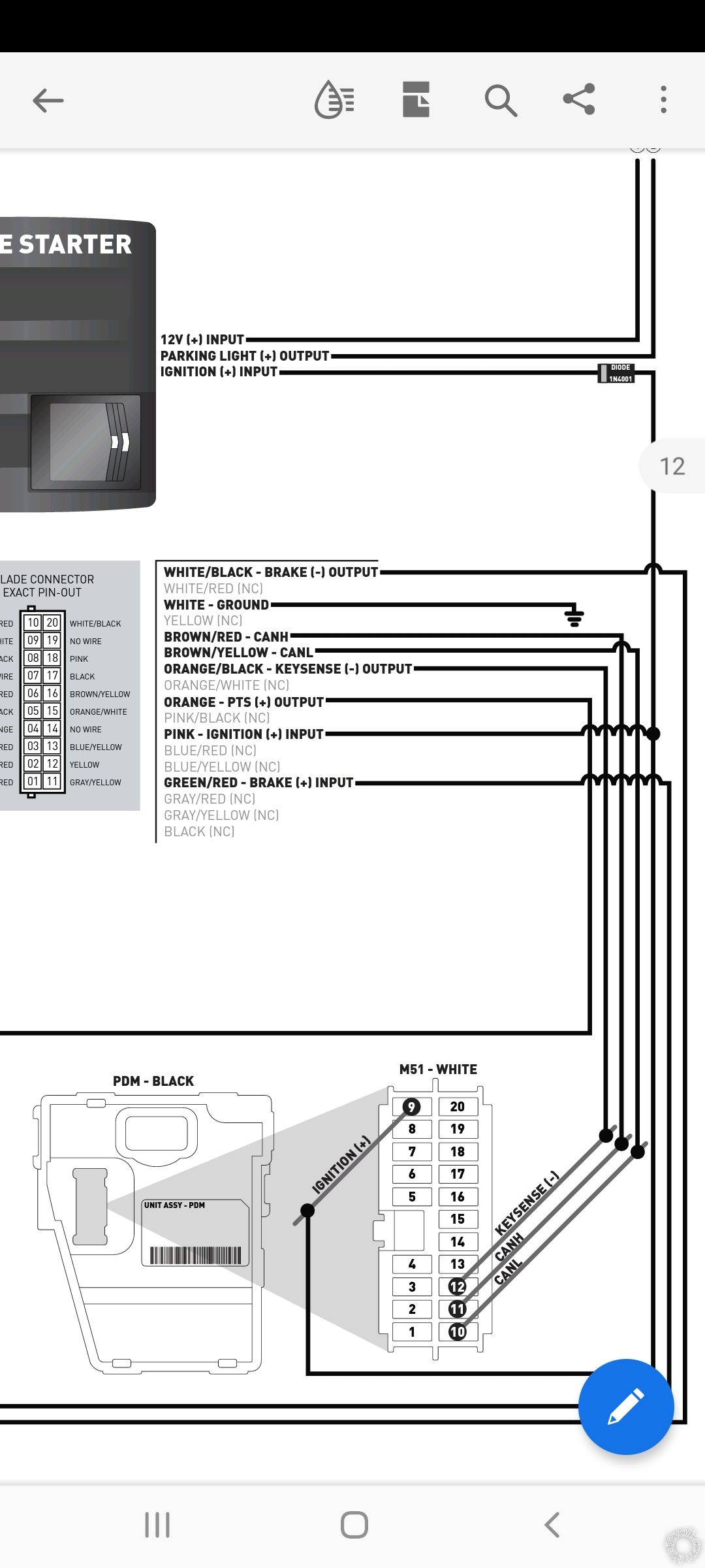

I am installing a remote start in my 2012 Hyundai Genesis Sedan, push to start. I am almost done. Lock, unlock, and trunk release buttons on the compustar remote work as they should. When you press the remote start button, the parking lights flash once, the ignition turns on, but it does not crank or start. I get a parking light flash pattern of 3 flashes, then a pause, then 5 flashes. This indicates a "foot brake on" error. I wired the relay for the brake switch just as it is in the diagram. 12V positive to pins 85 and 30, brake negative output from remote start module to pin 86, and both the brake positive input from the remote start module and brake 12V positive wire from the brake switch joined together at pin 87. Here are a couple pictures of the relay on the wiring diagram. And the two brake wires from the remote start module. According to this diagram, am i suppose to conmect the brake positive inpit wire from the remote start module directly to the 12v brale wire, then run a wire from the brake positive input wire to pin 87? Wouldnt that be the same as connecting the brake switch wire and brake positive input wires to pin 87 together? Remote Start Brake Switch Relay - Last Post -- posted image. Remote Start Brake Switch Relay - Last Post -- posted image.

yes, you go from the factory brake wire to 87 and also running green/red (bypass module) to the same 87. your kind making a V or 2 wire to one connection. and of course 86 goes to the white/black and 85 and 30 to constant 12 volts

Follow the diagram.
How it works...
The vehicles Gray Brake (+) wire is monitored by the R/S system for a couple of reasons. It allows "take over" of the remote started vehicle ( unlock the vehicle, open the door, get in and step on the Brake pedal = take over). It is also used to prevent a R/S if the brake pedal is currently depressed. That same wire is used by the Compustar system to allow a R/S. When a R/S is imitated, the Compustar system first checks to ensure the Brake pedal is not depressed, then is uses its' internal relay to output a (-) signal ( White (-) input to White/Black output ) that in turn energizes the external relay that provides a (+) signal to the vehicles Brake wire to fool the car into thinking someone is stepping on the Brake pedal and allow a R/S.
"And the two brake wires from the remote start module. According to this diagram, am i suppose to connect the brake positive input wire from the remote start module directly to the 12v brake wire, then run a wire from the brake positive input wire to pin 87? Wouldn't that be the same as connecting the brake switch wire and brake positive input wires to pin 87 together?"
Not sure of the question above. Basically, follow the supplied diagram. You didn't mention the exact R/S model but I'm assuming a CM900-s unit. While the wiring guide is good, it assumes a generic R/S unit. With a CM900-s you would combine the two fused +12V Input wires into one wire and connect as shown. Not shown is the required Black Chassis Ground wire. There should be no need for other CM900-s wires like Lock, Unlock, Brake, Disarm, Hood and Tach. These are handled by the Blade cartridge and the CAN Bus wires. The Horn wire would be optional.
Make sure you use 1N4001 diodes that are oriented correctly.
