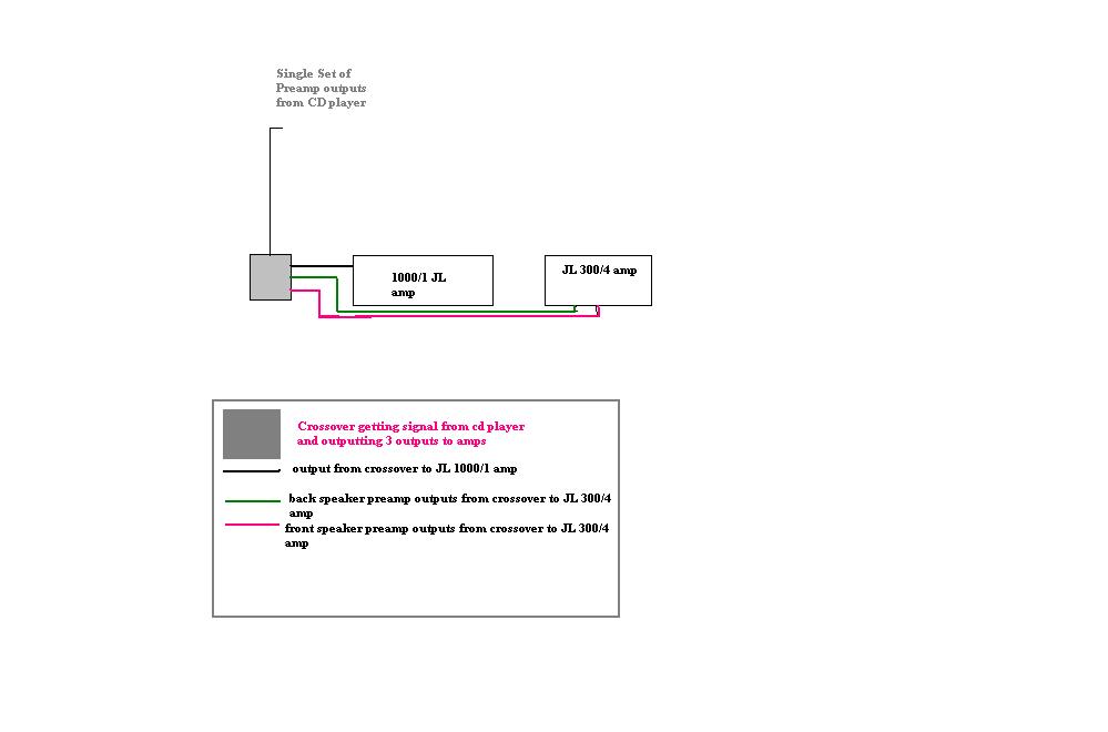

customsuburb
Gold - Posts: 1,813
Joined: January 17, 2004
Posted: January 27, 2004 at 8:19 PM / IP Logged
Here ,this should help:
Running 2 amps with 1 RCA out from Radio? - Page 2 -- posted image.

carguy411
Silver - Posts: 683
Joined: April 02, 2002
Posted: January 27, 2004 at 9:24 PM / IP Logged
hay thanks for the diagram
also what zapco one are you talking about u said ud leve alink but theres none there thanks
