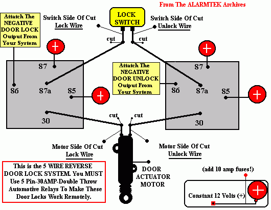

Another problem im having is with my power door locks. I have a 5 wire reverse polarity system. I tied them in with 2 5 pin double throw relays and they dont operate with the remote. I got the diagram from an installer and im certain i wired them exactly as his diagram shows. What could be the problem with that?

Alright, I was wondering what that other harness was for. As far as the door lock wires, yes they are the correct wires. I tested them with a multimeter.

791xv, 1995 ford f 350 diesel -- posted image.
That how I have it wired..

doulb check your wiring. also check the relays to see if they are ok.

I can power all the 12v one from one feed, right?

Posted: August 12, 2005 at 6:39 PM / IP Logged
yes u can power al the relays form the same source. once you cut the wires did the locks work. they should nto work. jus tmaing sure you go tthe rigth wires
