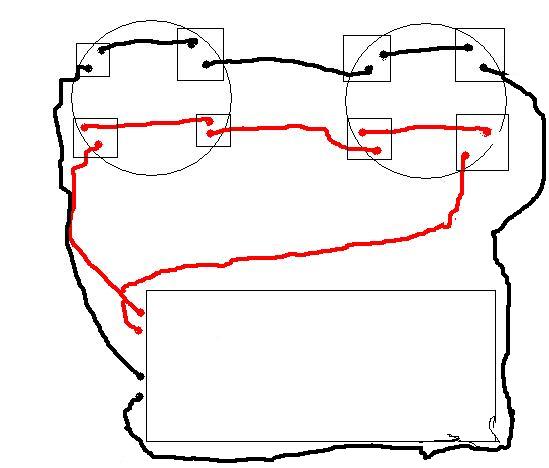

i got a hifonics bx1500D, and 2 15" audiobahn subs. optima red top. stock alt. stinger wiring.
none of the hookups are the prob i got a meter and its getting plenty of power and a good ground.
im pretty sure my subs are wired for 1ohm operation.amp shuts down -- posted image.
but when i opened the amp case there was a small burn mark on the case??
let me know what you guys think. thanks

There's no need for the jumper wires that run from one sub to the other- remove them.  Have you checked the impedences?  Is your amp still under warranty?

so i dont need the one black and one red from left sub to right sub?
im pretty sure it was 1 ohm but i didnt check with a dvom

4) There is an electrical problem in one of the speakers, in the amp, or in the wiring.  That diagram is wrong, by the way.
